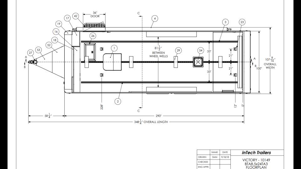

Hi guys, in build of my NFGT trailer.
Are you finding the wheelwells height the problem??
My drawing shows 81.5"

No width. We have 2 trailers one is 80, the other is 81" wide. There is literally an inch or so from the GT wheel to the trailer wheel well. Lots of discussion about opening the door, but you have to get the car in the trailer 1st. You need experience, patience, and a good spotter to simply get the car in. One solution is over the wheel well ramps, then you pick up the ~8" that the wheel wells creep into the trailer floor.
