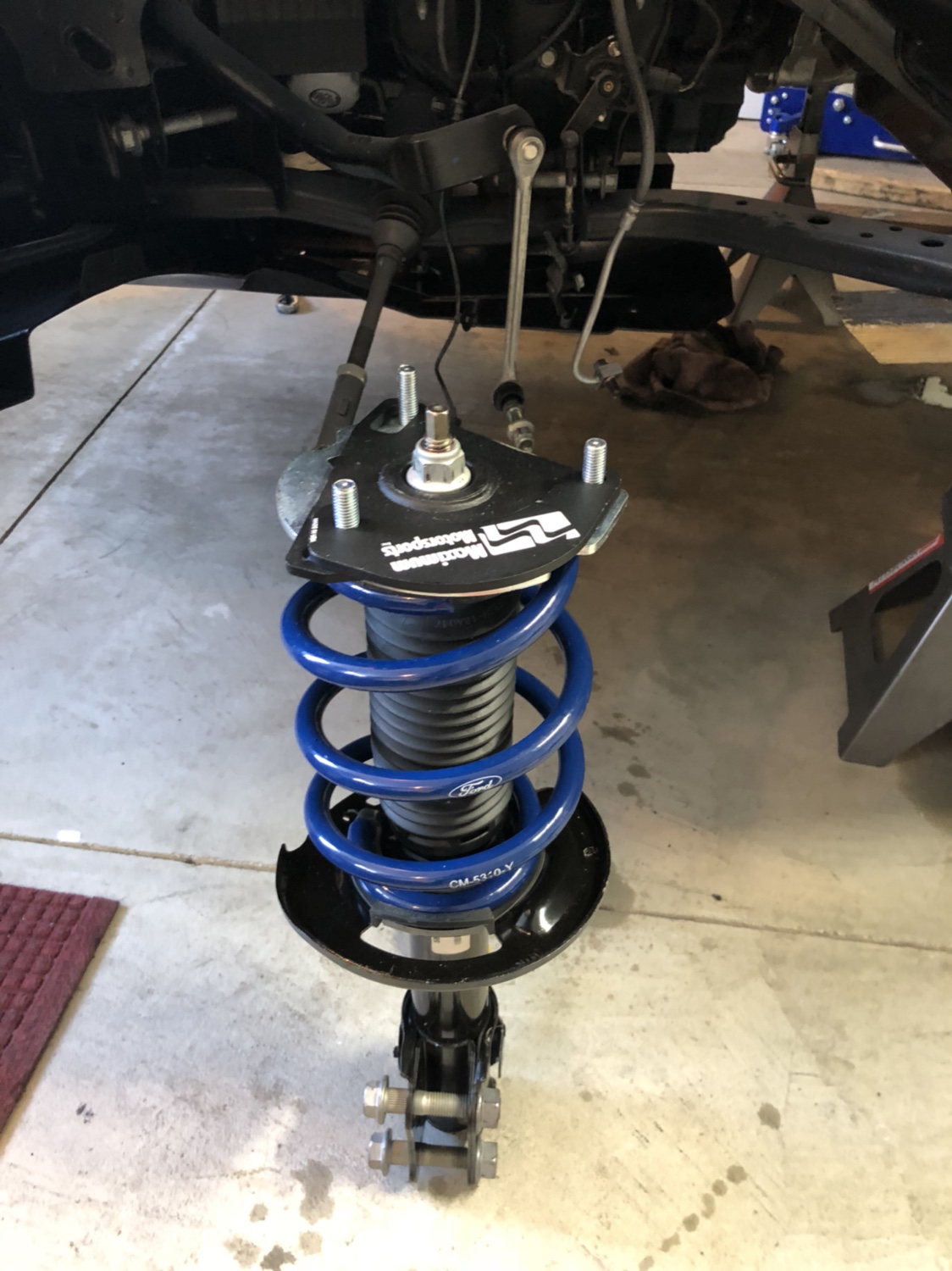

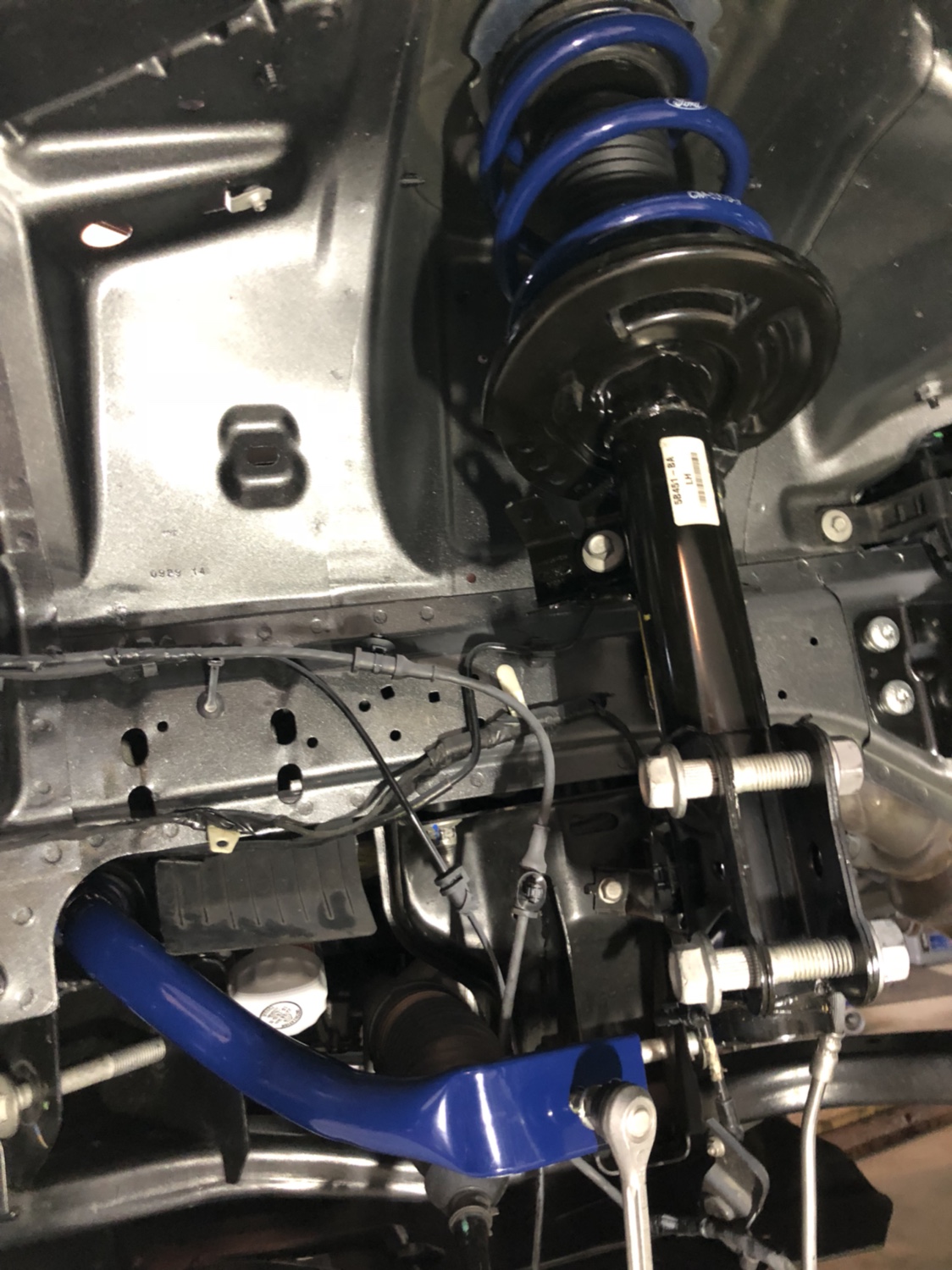

Installed Ford Performance front anti roll bar, lowering springs, Maximum Motorsports camber plates.

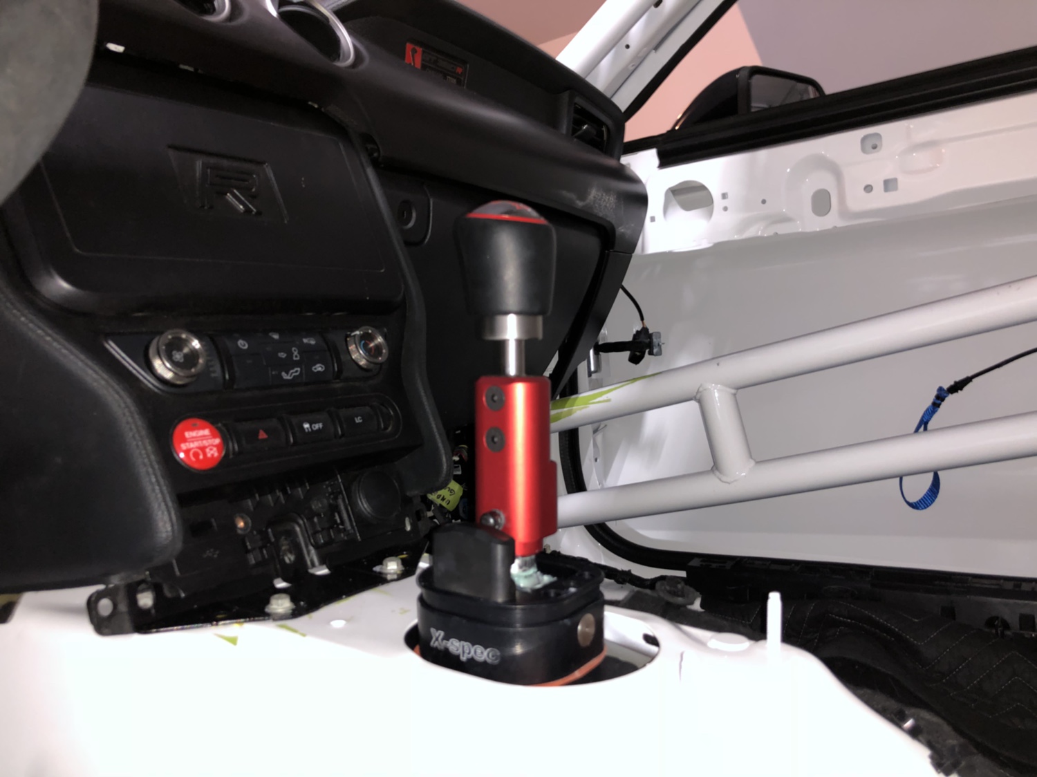

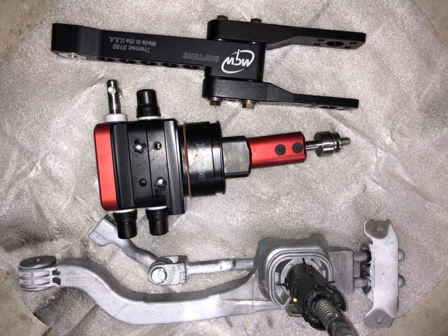

MGW short shifter installed. Look at OEM for comparison.

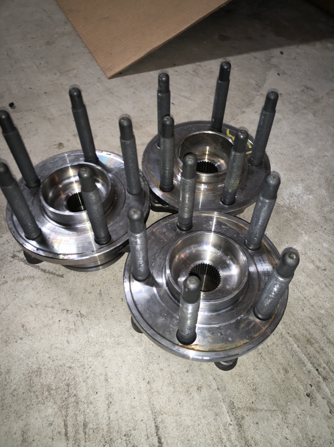

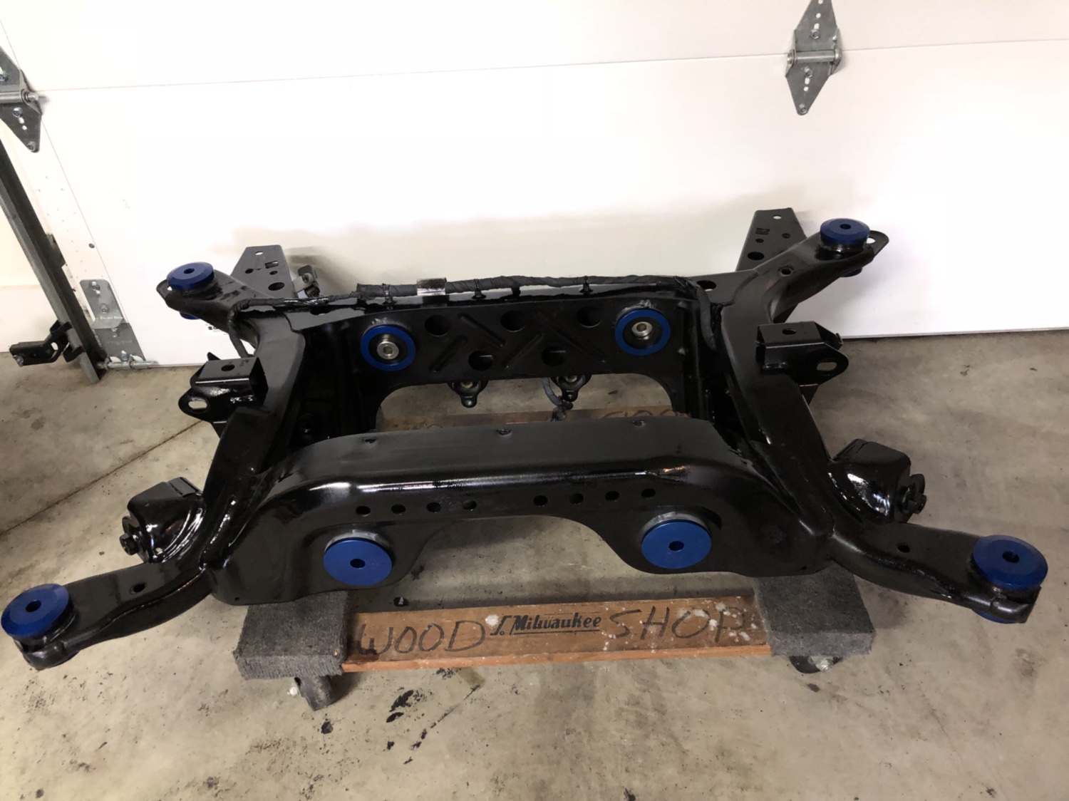

Completed the install of the FRPP Aluminum cradle and diff bushings. Now I can put the IRS back on the car. I also installed GT 4 studs on all hubs. They are quite a bit longer than stock.
spartan
Feb 11, 2017
1,223
Bloomfield Hills MI
GT4 studs. They look like ARP studs just not anodized gold.

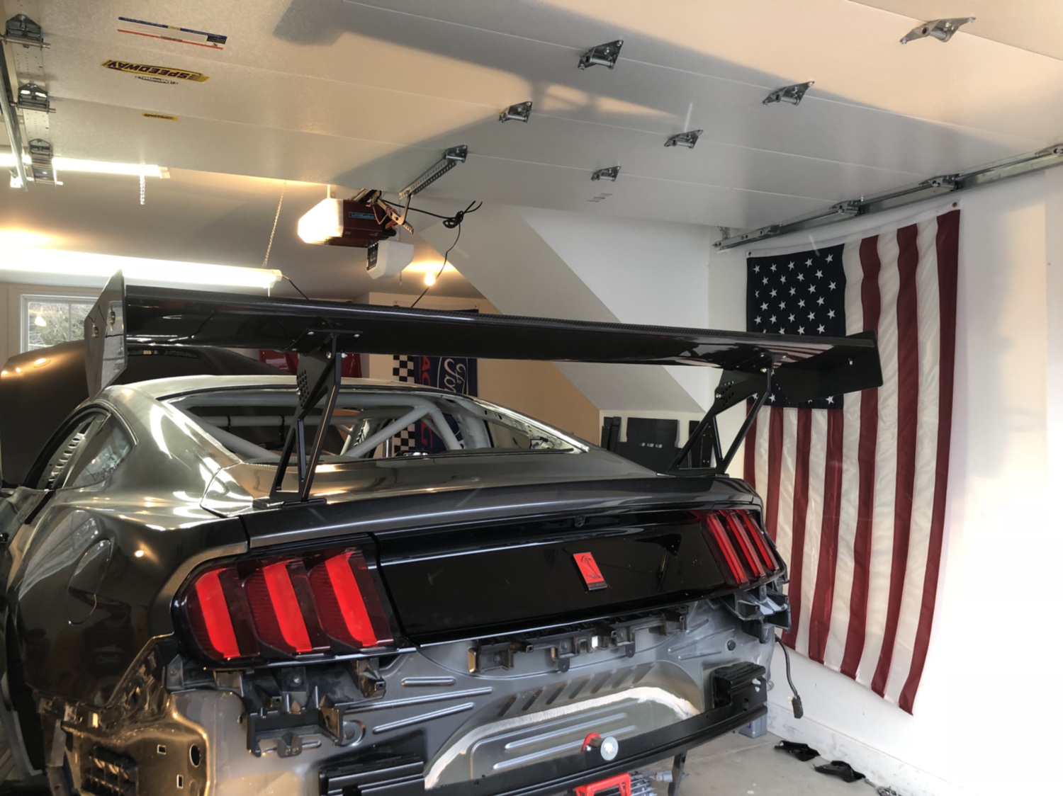

Wing installed.

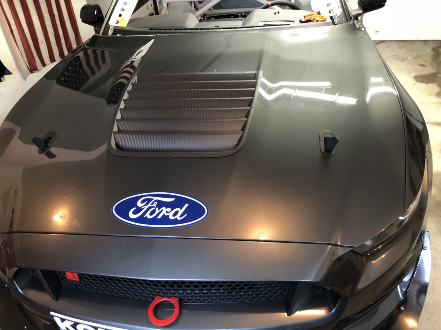

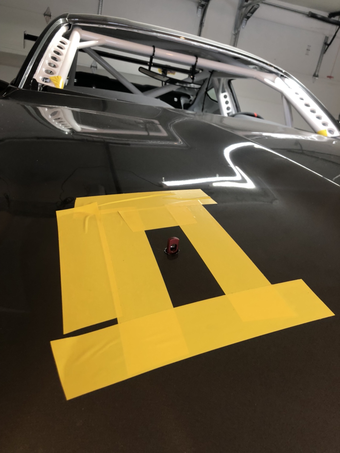

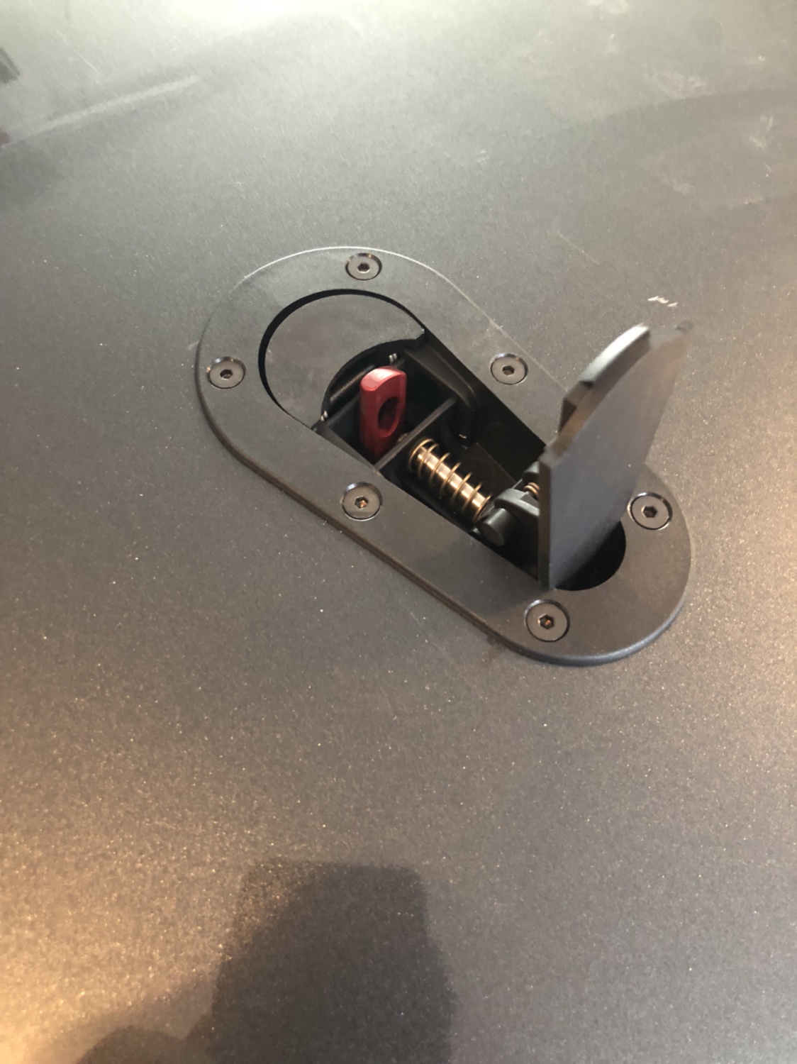

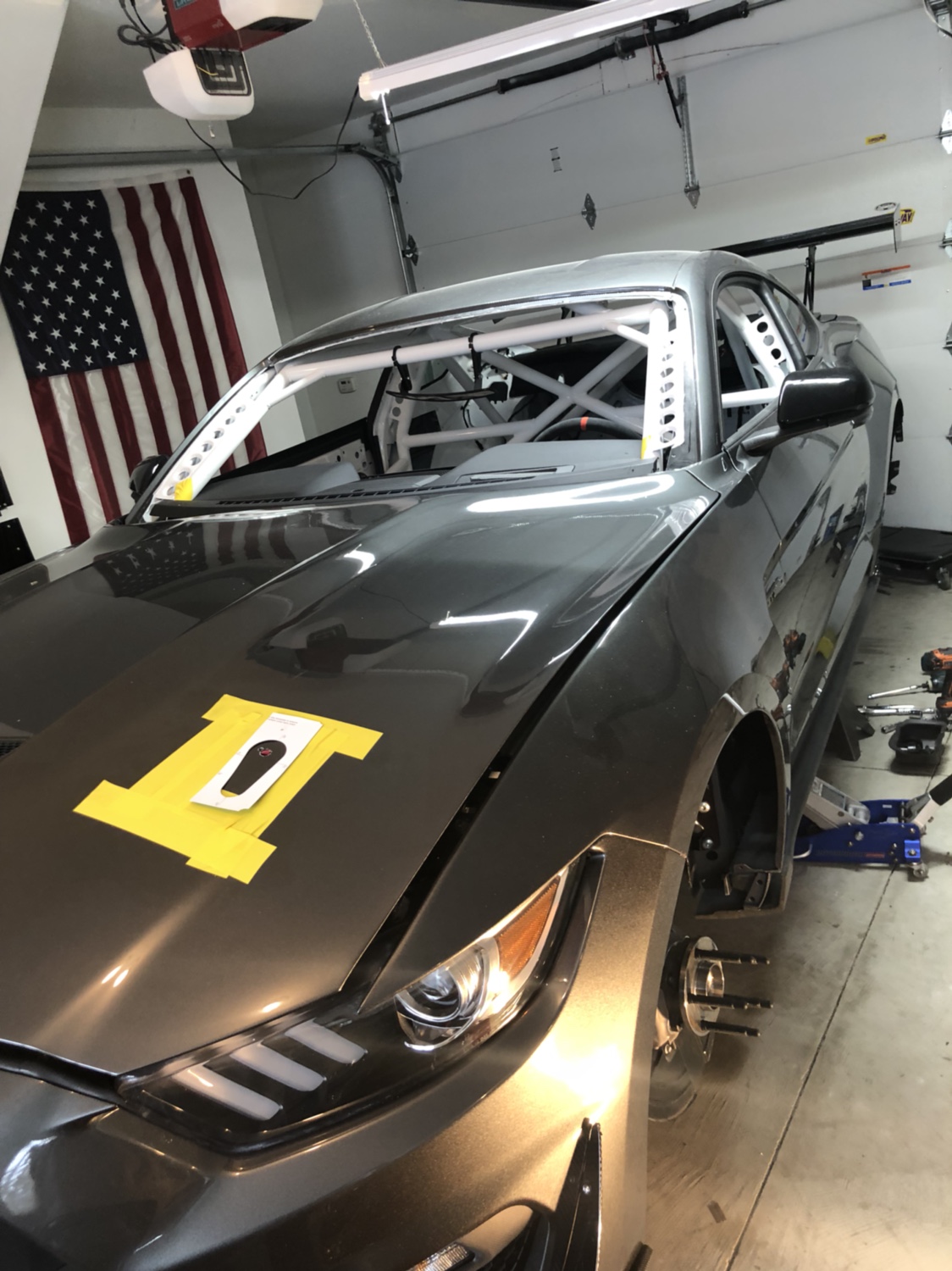

Installed Aerotech hood latches.

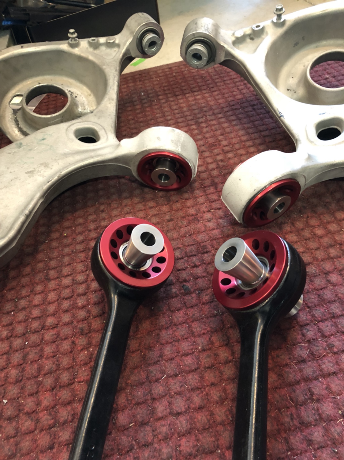

Cortex monoball lower control arm bearings

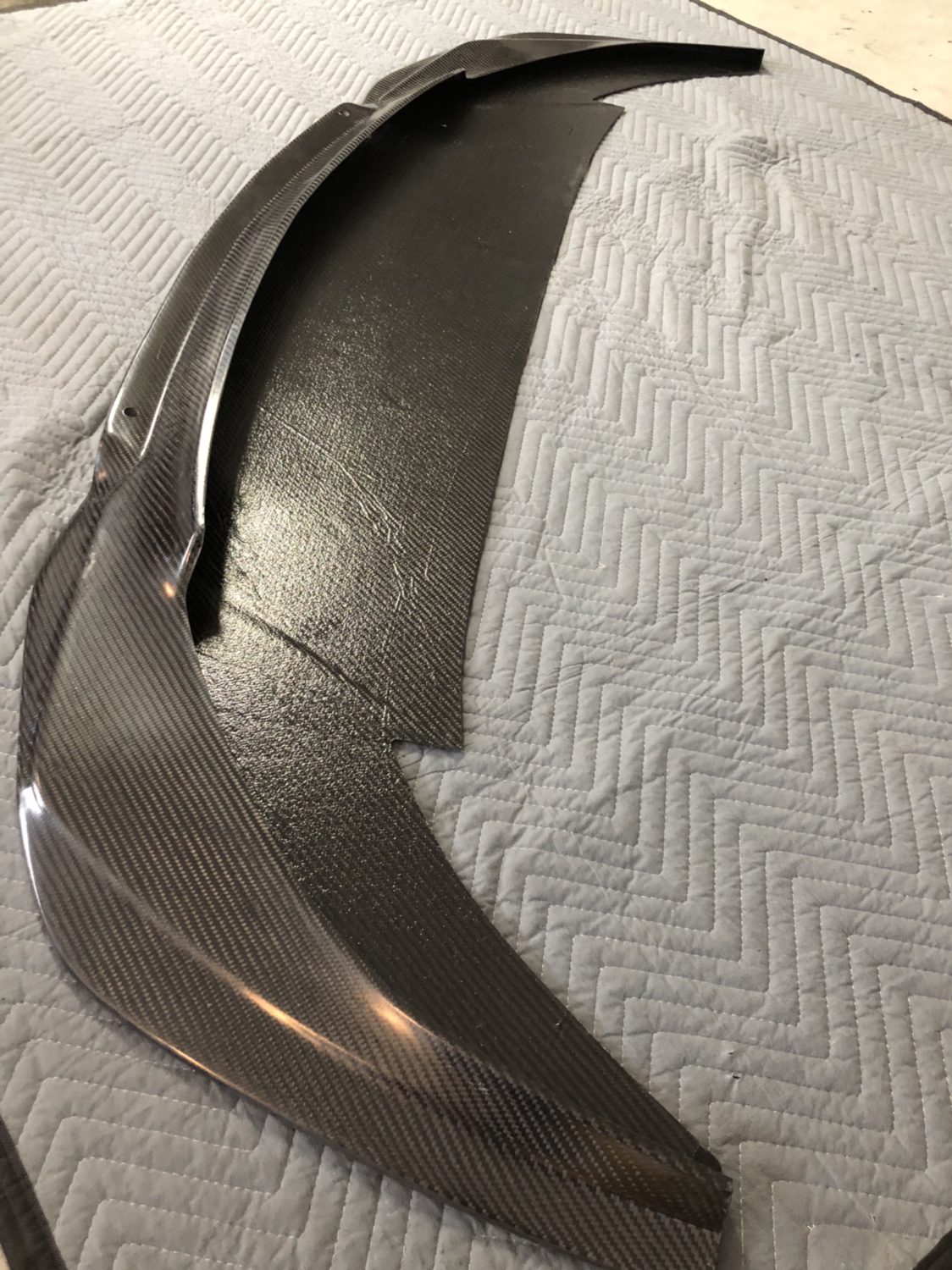

GT4 reproduction CF front splitter.

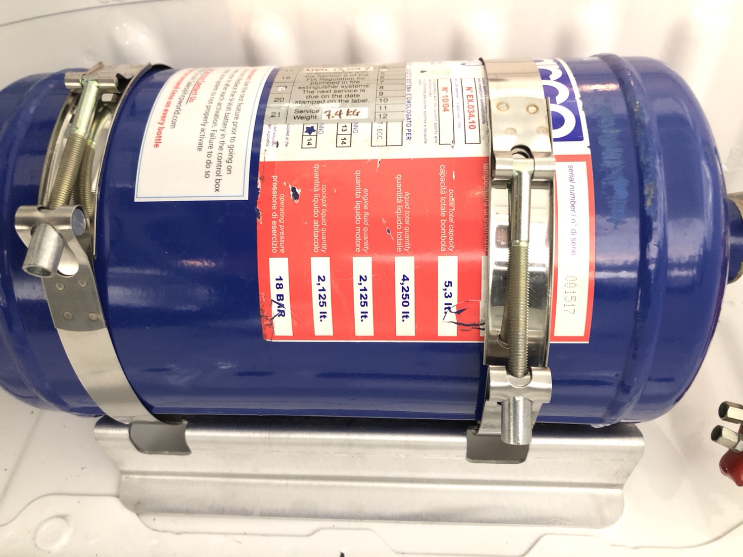

Fire suppression

I put the MGW shifter in my car it feels super tight compared to the stocker.

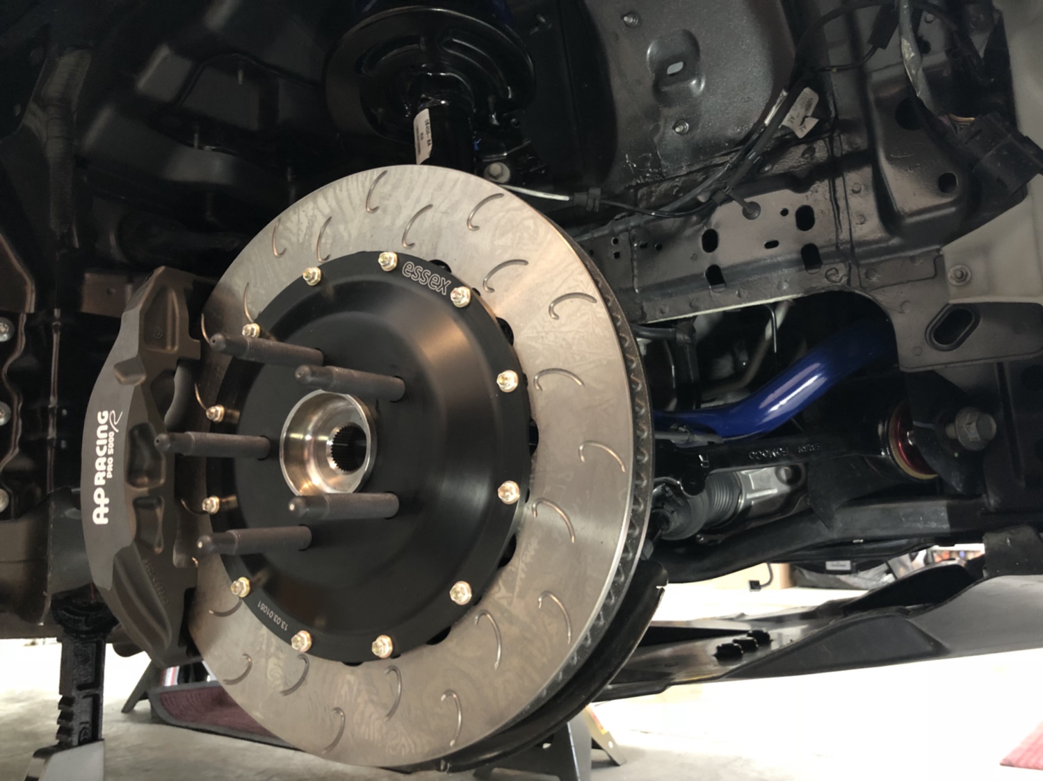

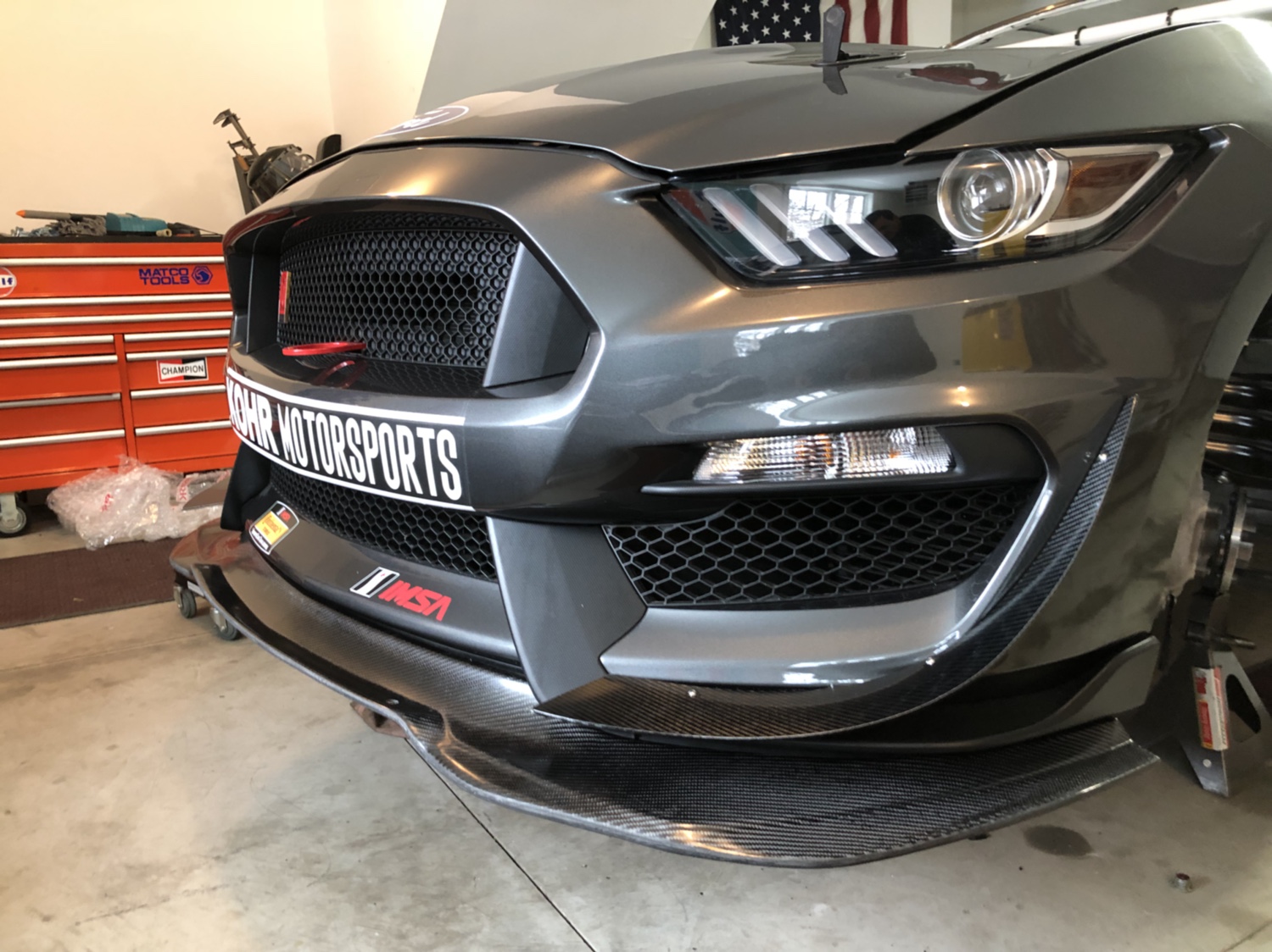

Installed the CF splitter and test fit the new brake setup.

My idea of a track car [emoji4]

those aero pieces on the front look crazy

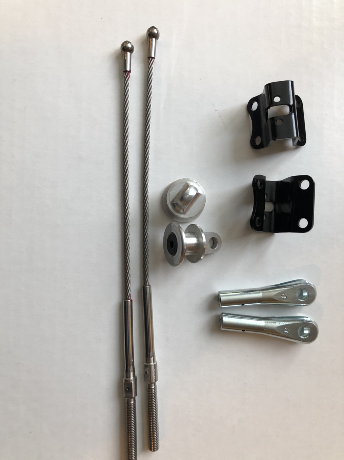

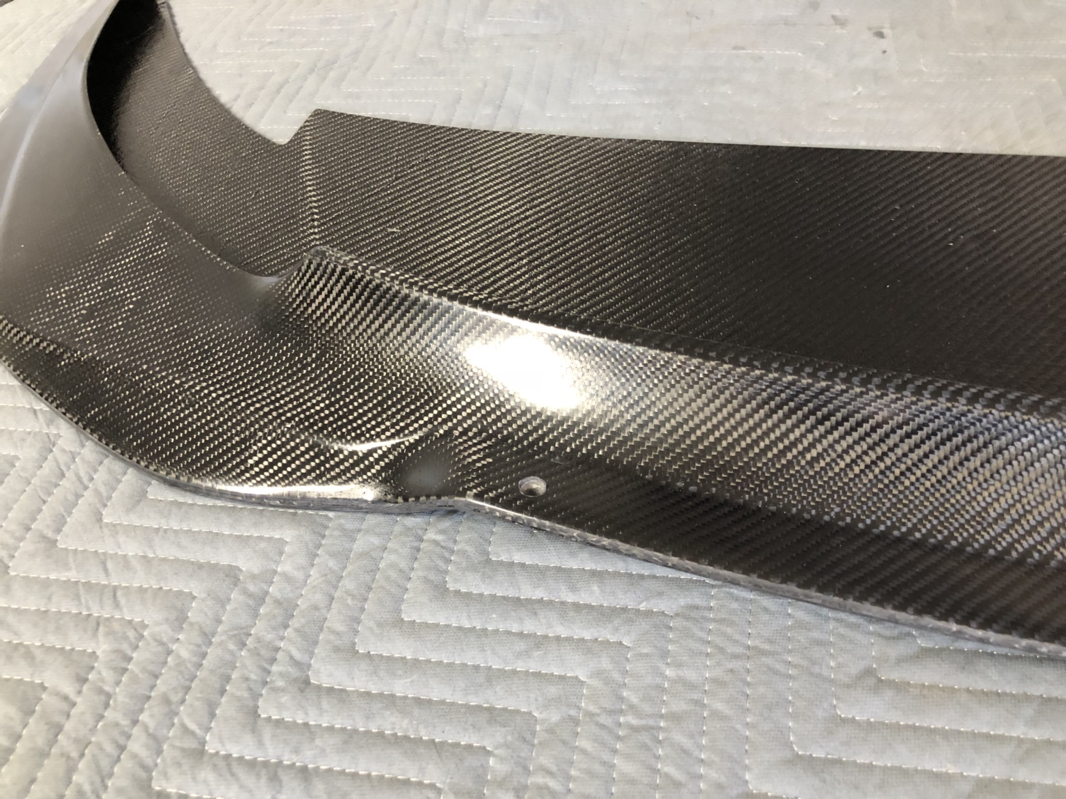

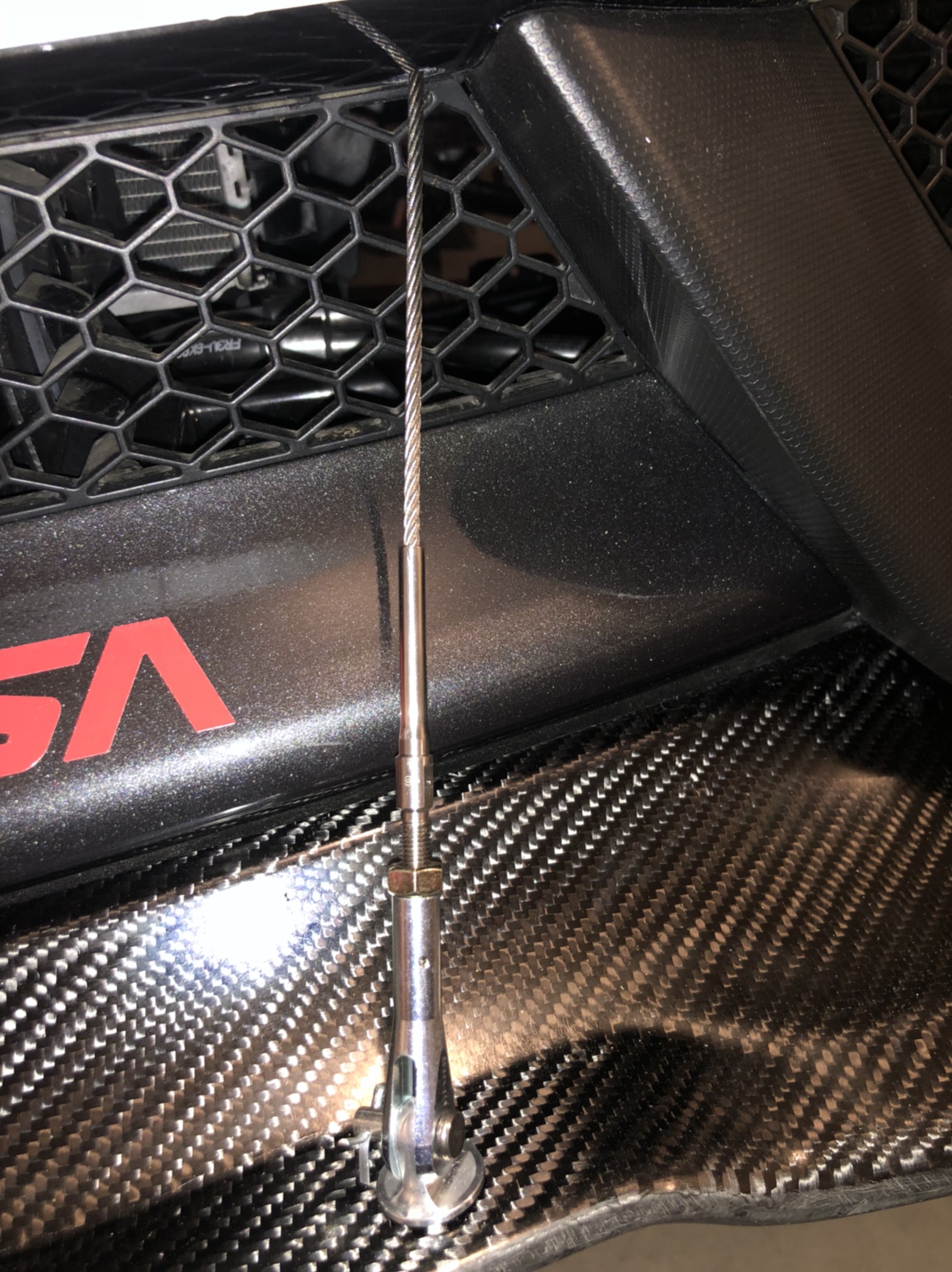

Installed a CF GT4 hood vent. Notice the GT4 splitter hardware is not a rod but a cable.
