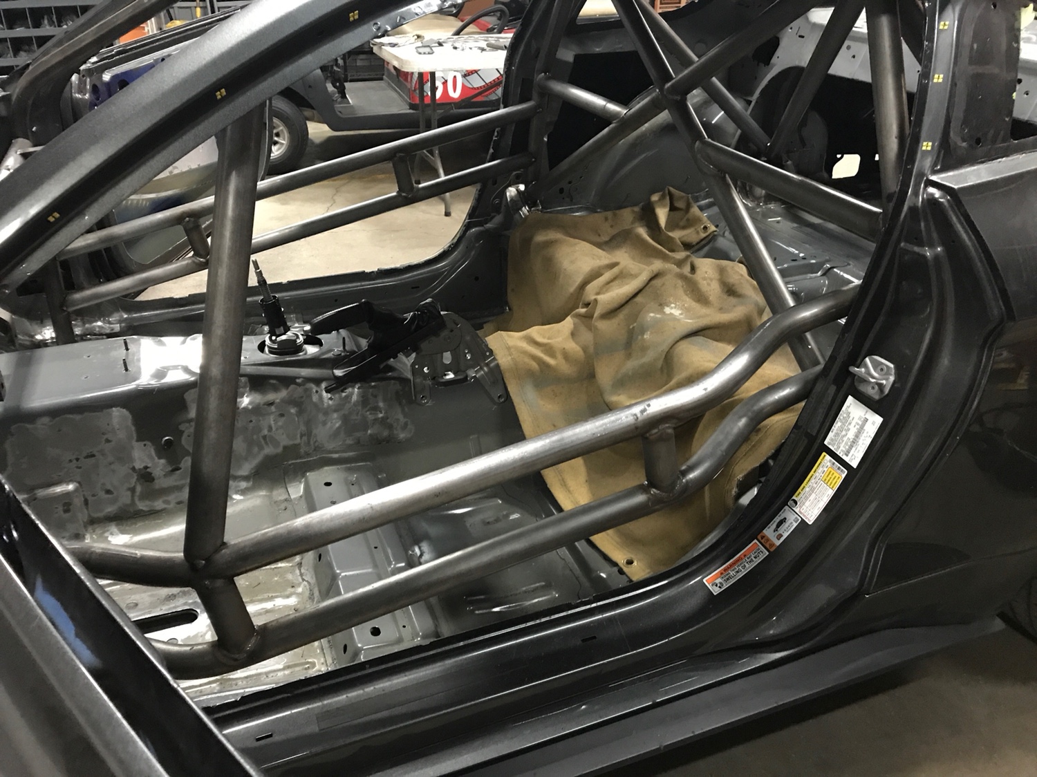

Photos of the Watson cage and seam stitch welding.

Cage coming together

Fred- give me that screw driver you're using to turn the car. I can get it wrapped in carbon fiber!
8,138
Looks awesome!

seen the car the other day at the painters. love the way the cage ties into the "A" pillars. very smart
