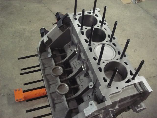

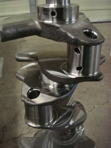

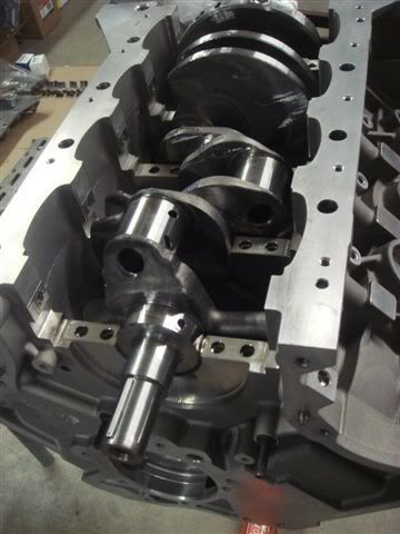

The machine work on the block has been completed, the custom CP pistons that were treated to Teflon coated skirts and ceramic coated faces and then wrapped with hand fit stainless steel rings are on site, the rotating assembly has been methodically balanced this after the crank was magna-fluxed and then the journal sizes verified and then it was micro-polished....,​

You will see that the custom CP pistons, the stainless steel rings, and the light weight Manley I Beam rods (a paltry LOL 32 grams lighter per rod) are becoming one and that the fully massaged crank is being reintroduced to the block wrapped in Federal Mogul’s Speed Pro bearings as well as the fully assembled short block complete with ARP's latest head stud offering rather than OEM head bolts. These head studs are their 2000 series that allow for a head torque of 100 ft lbs which is "HUGE" when compared to the OEM torque value of approximately 65 ft lbs when you consider the torque to yield value. Furthermore the use of head studs insures a much more even clamp load and torque retention over time.

Well we are just about ready to place this gal's heart back into position.
Here are a few pictures as the creation of this "Redhead" continues.
Sadly you will see that the primary cam chains are not in place because I ordered the incorrect hydraulic chain tensioners; I ordered those for the cam to cam chain rather than the primary chain as such the process has been delayed by a few days otherwise we would have her heart in place this week-end. The reason for the new primary can chain tensioners is the fact that they have a molded in place o-ring that if not replaced pose a concern for oil pressure loss at these points.
FYI: the reference to “Redhead” is the description of my engine builds with the powder coated red valve covers being the finishing touch. You will also see that the original build tag is sitting on the valve cover and will be properly re-secured before she leaves.

Take a look at coolant passages in the block on the early photo and then look at the coolant holes in the head gasket. Note that many of the passages are reduced in size and the ones at one end of the block are full size. I have read posts on modularford.com that the mod v8 has a tendency to overheat the rearmost two cylinders. I have also read that this has been address in the GT motor. I believe these photos confirms that.
:thumbsup
You are funny and yet the "thumbs up is truly appreciated"
As for the coolant passenges; good eyes.
