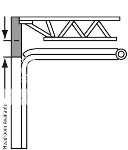

I'm getting ready to buy a lift and need to raise the height of my garage door opener. It hangs down about 25" from the ceiling and I can slam it right up to the ceiling. My question is about the garage door tracks. Is it as simple as replacing the 74" tall vertical tracks with something closer to 90"? And then moving everything up? Or is there more to it? I know they make wall mount units, but dont think I need to get that extreme.
Any input greatly appreciated
Yes

And yes, as for the tracks, you can send the sectional door up higher and out of the way by simply repositioning the tracks assuming you have the room (height).

as for the tracks if you look there is the vertical rail and the top curved rail, all they do is just replace the straight vertical rail with a taller one and reuse the same curved rail and reposition it closer to the ceiling . the other reason for a side mount opener is that mounting the regular opener much higher on the ceiling usually affects its ability to pull the door up. I suspect that may be why GT jack had to add another panel to his door. with the side mount opener there should be none of those issues

You can do it yourself in an afternoon. Measure how much higher you want to go, saw that length out of the horizntal section and bolt it into the vertical section. Add a jackshaft Liftmaster and you're don. Little bit of tweaking/adjustment needed, but it's simple. Added benefit of Liftmaster is that it automatically engages the deadbolt once lowered.

I have 12 of these and agree, they are great. They are direct drive to the shaft that holds the springs. Just ask a door company for a high clearance door track that brings the tract within 2-3" of the ceiling.
