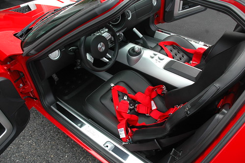

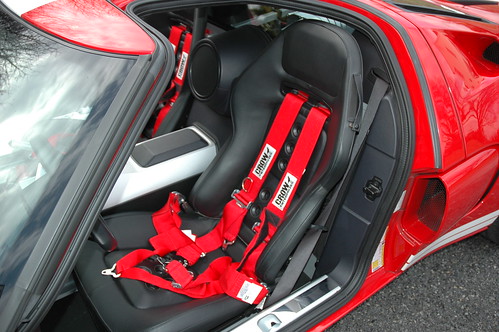

I was very happy with the 6 point harness set-up that I used for the GT school. (the belt that comes up between your legs is not attached in the second pic) It is easy to revert back to stock and looks really cool. :cool You can clip the harnesses in for the event and be back to the stock seat belts within 5 minutes. Here are some pics......

Same firewall attachment as Skyrex, but 6-point harness instead of 4. Just another option.
Skyrex, did you get those GT40 belts and cam buckle from Cobrar?
They look nice!
They look nice!
Yes, I got them from Wally. Great guy and he really developed a great product for both looks and function.
He actually came to the school and helped a couple of us get into the harness for the first time. It looked confusing at first, but after you did it once it was a piece of cake to get in and out of the harnesses. Although it does take a little getting used to when you bring that fifth harness point around the "family jewels" :lol
Definitely a product I would recommend. :thumbsup:thumbsup
