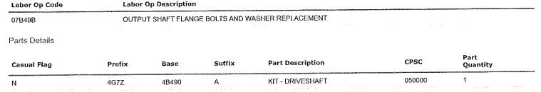

Thanks all! (I read all 12 pages of the CSP-transaxle bolts)
For those who lived through this, it looks like the FINAL SOLUTION Ford fix was part #4G7Z-4B490-A
On my paperwork above I do not see that # called out? Does anyone know if this might be available from Ford?
So it looks like I may/should have this redone.
1) Anybody know of a good Ford Dealership within (let's say) 100 miles of Pensacola, Florida that could handle this? Treadwell Ford (Mobile AL) was recommended back in the day.
2) Is it "warranty" work? 0$s (remember that it was done once in Dec 2007 by a Ford Dealership in Phoenix, Az)
3) Has anyone successfully gotten reimbursed for this work being done by an independent shop?
4) If I MUST do it/pay for it myself...AccuFab or Ford kit?

Please correct me if I am wrong but my research says the Ford "final solution" was part #4G7Z-4B490-A. I have gotten my local Ford Dealer to dig into the Oasis system and determine that the service done in Dec. 2007 included this part # (see attached)...so I feel I'm good to go. Agreed?

I have an invoice for recall 07B49 transaxle output bolts performed in 08 am I good to go?

My recent research and understanding (which hopefully will be corrected if wrong) was that Ford had some fast (and it turns out intermediate) but less than adequate solutions until late (Dec) 2007. Ford "final solution" was a kit designated part #4G7Z-4B490-A. This morning I got a helpful Ford Service Tech in Pensacola, Fl. to look up my VIN and (by giving her the date of service back in 2007) she was quickly able to pull the parts document used during the (Dec 2007) 07B49 repair (Part #4G7Z-4B490-A).
