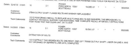

I followed-up on this after reading this warning (again). My bolts are silver and the paint lines up so I was concerned. I found the attached in my paperwork...should I be good to go?

I think 2007 was too early for the second, correct, Ford fix. Others will chime in to identify the clues as to whether you have the first (incorrect) fix or the proper second.
Tomcat
Roger, I hope other's can clarify for me...Thanks! (Dec '07 work order)
Tomcat
Might any of the experts be able to look at my paperwork above and determine if I have any reason to be concerned about my axle bolts? Thanks!l.p.

Here is a link to a long thread of the axle bolt replacement program. The first replacement bolt kits, from Ford, became available 12/2007. I would assume you do not have the final revision, since your paperwork also has the 12/2007 date.
Tomcat
Thanks all! (I read all 12 pages of the CSP-transaxle bolts)
For those who lived through this, it looks like the FINAL SOLUTION Ford fix was part #4G7Z-4B490-A
On my paperwork above I do not see that # called out? Does anyone know if this might be available from Ford?
So it looks like I may/should have this redone.
1) Anybody know of a good Ford Dealership within (let's say) 100 miles of Pensacola, Florida that could handle this? Treadwell Ford (Mobile AL) was recommended back in the day.
2) Is it "warranty" work? 0$s (remember that it was done once in Dec 2007 by a Ford Dealership in Phoenix, Az)
3) Has anyone successfully gotten reimbursed for this work being done by an independent shop?
4) If I MUST do it/pay for it myself...AccuFab or Ford kit?
6,216
2. Warranty has long expired. It was a Technical Service Bulletin not a recall.
3. Sorry, it's your nickel.
4. Is the Ford kit still available? Accufab may be your only choice.
