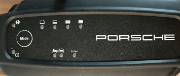

This is a CTEK charger I got for my old 997. Can I use this to trickle charge a Ford GT? Plug it into cigar jack?

2,530
Yes. It has a Li-Ion mode.
Doesnt a 05/06 GT have a regular battery?
Wondering why having Li ion mode matters
