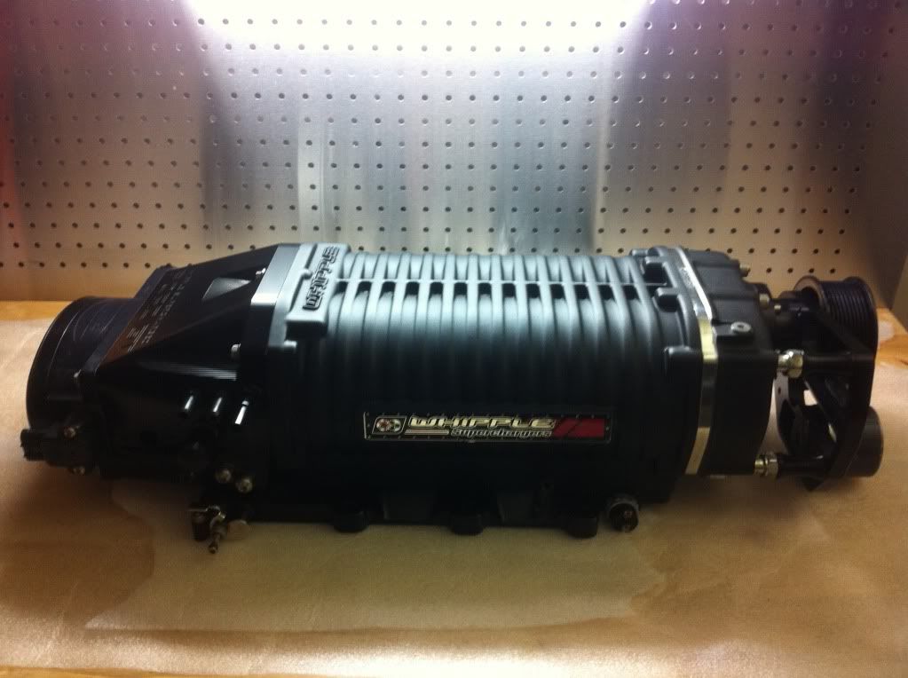

Thanks - should I look at an injector upgrade as well, or not bother? Best we have here is 94 and it's rare. 91 is mostly what we have all around here and it's 10% ethanol for the most part.
I wouldn't worry about that on the front end. With increased capacity from a dual BAP I can increase FRP to extend the size of the stock injector.

The 4.0L can be tuned down to match the fuel system. I think a third, external fuel pump would have solved my problems early-on... but I was expecting to do more mods down the road so my fuel system upgrade was more extensive than necessary... i.e.: don't be afraid of the 4.0L as an option. Just an FYI: I may be wrong but I think any 800+ hp numbers are going to be on 'special' fuel. BAP didn't help much IMHO but, as stated, I may have been dealing with a pinched fuel line inside of the tank.
As for long term usage, I think the stress on the crank, specifically the single keyway design, is amplified by 3.4L just as much as the 4.0L. However, when I dissected my motor and inspected the keyway there was almost zero wear on this item. I expected to see the keyway teetering on the edge of failure and it looked as tho it was barely broken in. My car had 33,000 miles on it (20k of which were executed with a 4.0L Whipple on the motor). Much of the failure is overplayed as the problems are expressed online, while the success (non-failures) go untold.
Get the 4.0L, and scare yourself silly.

There's no question now, I'm going with a 4.0L. I won't be nailing the pedal all day long and I feel that this motor is far more bulletproof than my 427 Z06.
