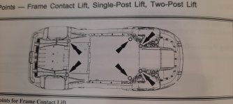

Thanks , the comments were very helpful . I am having trouble finding a diagram that shows the lifting points for lifting the car to remove the wheels so I can change the tires . Can anyone help with that , the dealer I've used since buying the cars hasn't been able to help .
Check here https://www.fordgtforum.com/forums/threads/fgt-knowledge-base.38620/

pscarb4
