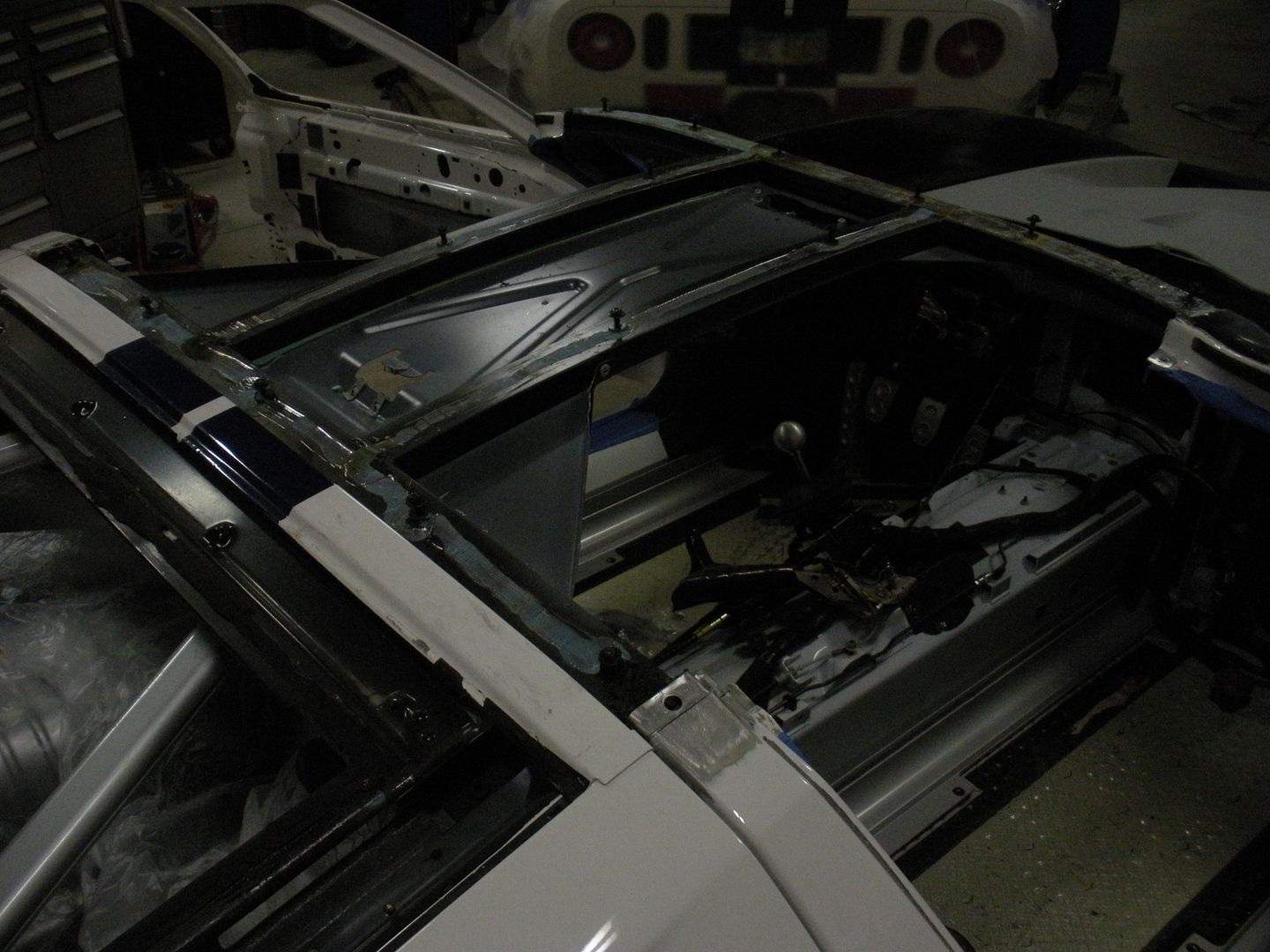

Looks like from where the roof panel and B pillar come together. There is a lot of body filler “Bondo” in that area from the factory around that seam.
Seen that on 2 cars but that was from after an accident. Must be some real bumpy roads up there.

The area shown in your picture appears to be on the vertical pillar based on the taper and the orientation of the latch. The connection Rich posted about is on the roof.

I agree with Gary. Not only do they not remotely look like stress fractures, but there is no way you would have stress fractures at the pillar.
Ditto Gary and Sinovac comments: The middle of the pillar is an odd place to have stress cracks, let alone two of them side-by-side. Cracks generally occur at "stress risers" such as sharp corners. I have 43,000 miles on my '05 and don't have any cracks anywhere that I've noticed.

You can have peace of mind knowing that underneath that body panel is probably the strongest section of the extruded aluminum hoop. The frames on our cars are amazingly robust.

Looks like stress cracking of the panel at the compound curve when you get lateral movement. The "arch" is flexing. If it was a flat panel ...it would have flexed but because of the wrap-around it cracks. Seen this on older corvettes that are raced. My 2 cents worth

That's scratches in my opinion. Do not look like stress cracks at all. We see lots of stress cracks on front bonnets and plastic bumpers, but not typically in that area. But, none of us can see it in person so very hard to determine from a photo.
