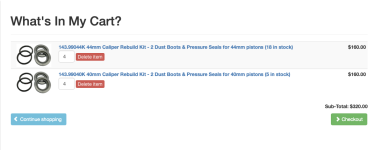

Im measuring the piston sizes today.
So far I know the larger rear piston is 44mm wide so the general rule (info on Zeckhausen Racing site said) says is that boots will be 10mm larger (54mm would be the order size)
Not measured the smaller piston as I'm having trouble retracting the larger piston back in and getting the smaller one to pop out enough for width check.
On their site you can buy boots and boot/s seals to rebuild
Ive got a piston retraction tool coming today to help
I know the pads front and rear are the same size but are the calibers the same (I would think so as the pads seem to fit just as tight either end)?
Rotors aren't
Info on getting size right....
Here's what I think I need.
Expensive material....
I think the Ford dealer will be my option as I won't get them for 2 weeks with Zeckhausen

got 4 sets of these.
I upgraded to the high temp version.
Im guessing the stock stuff wasn't a high temp product.
