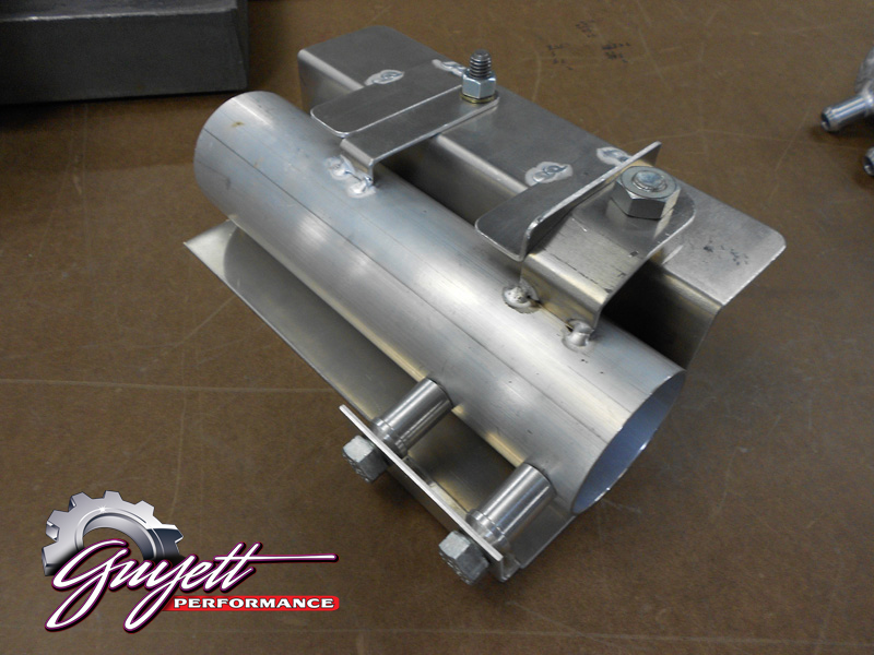

Sorry for not posting more photos sooner; we've been busy doing a very custom GTX1 (more on that shortly). Anyway, here are some additional photos of both units installed. I did 10 of each and they went quick; we have 5 more of each in powder coat now and can ship them this next week.

Is the last picture showing the unit in a jig ready for welding?
eg1985
Jan 7, 2007
82
Fresno, CA
Exactly
