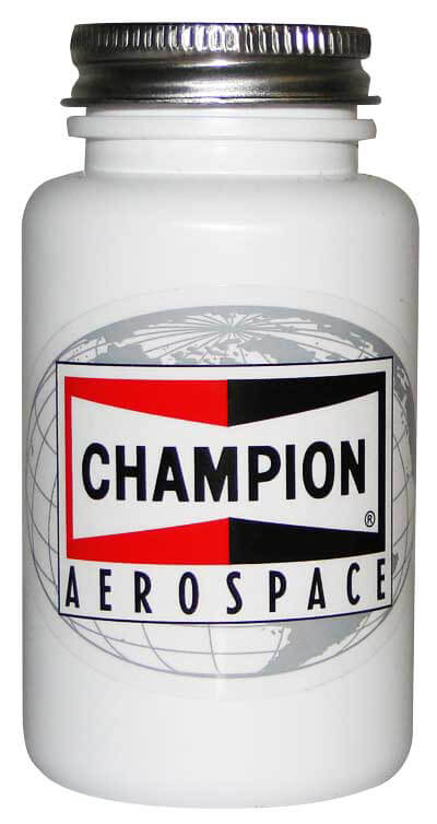

Aircraft engines have aluminum heads and have used spark plug anti-seize for eons. I always use nickle anti-seize on aluminum heads. I have seen plugs seize on aluminum heads - not fun. Make sure you do not get any past the threads. See instructions on link.

In addition to Ed's advice, use it sparingly.
