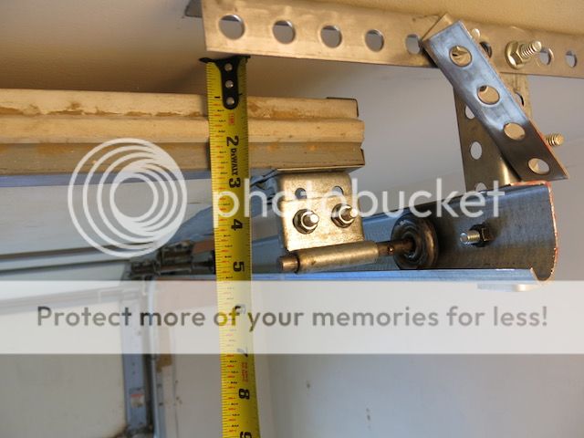

Keep in mind the garage door will take up about eight inches of clearance when open even after a high lift conversion.
under 3 inches is possible
