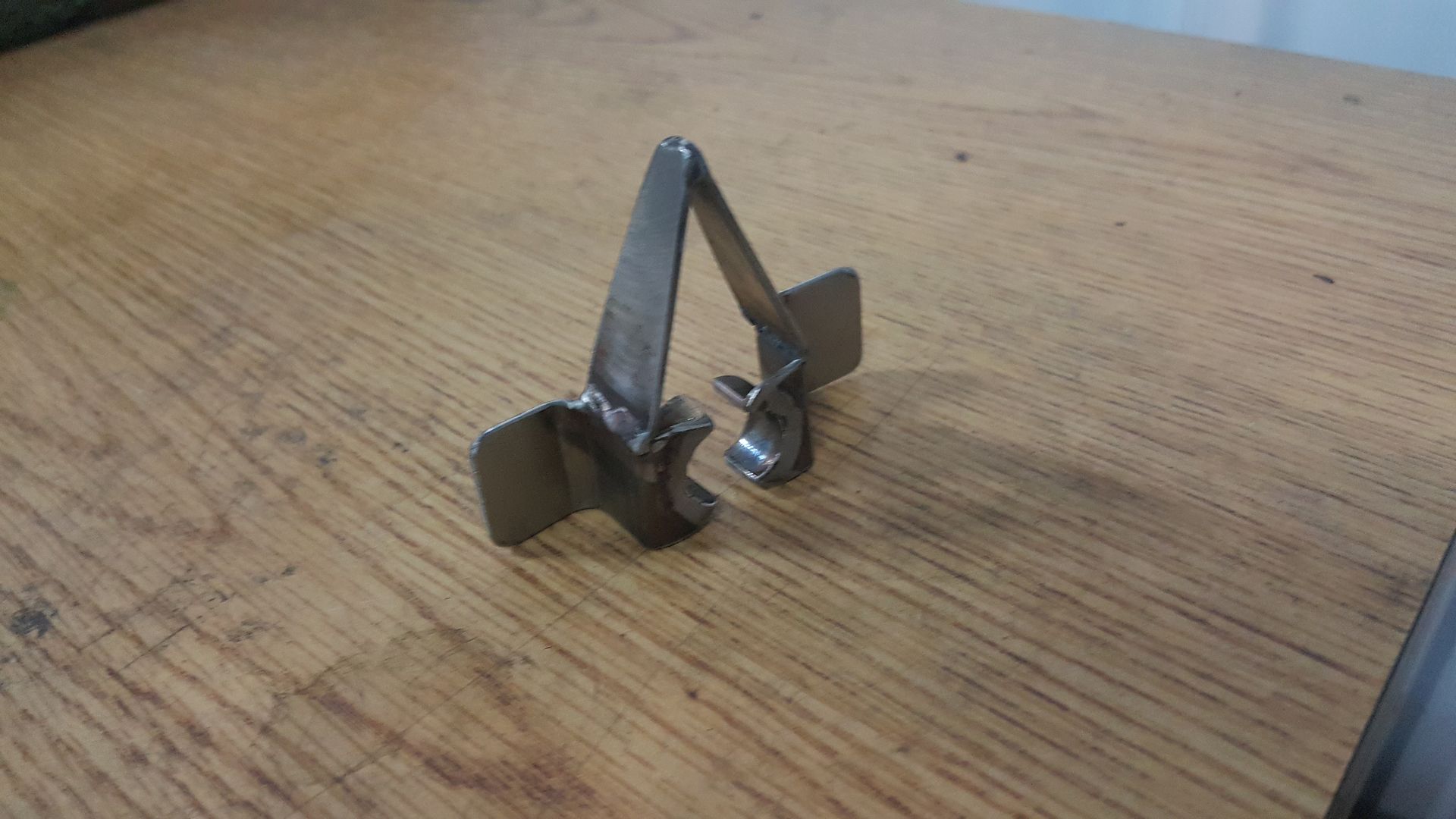

We have fabricated a special fuel line tool for the fuel lines on the cars. Off the shelf tools will work but you have to wrestle with them a little. This is the same tool that many of you have seen us use for the fuel filter.
