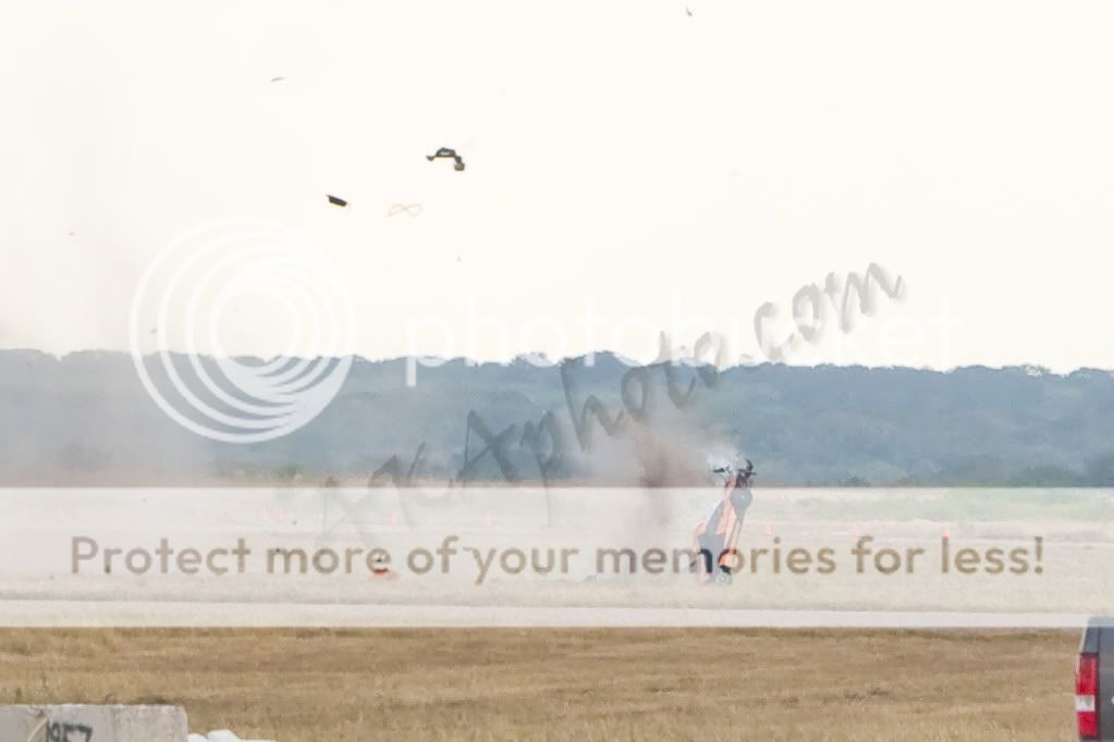

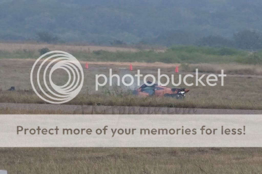

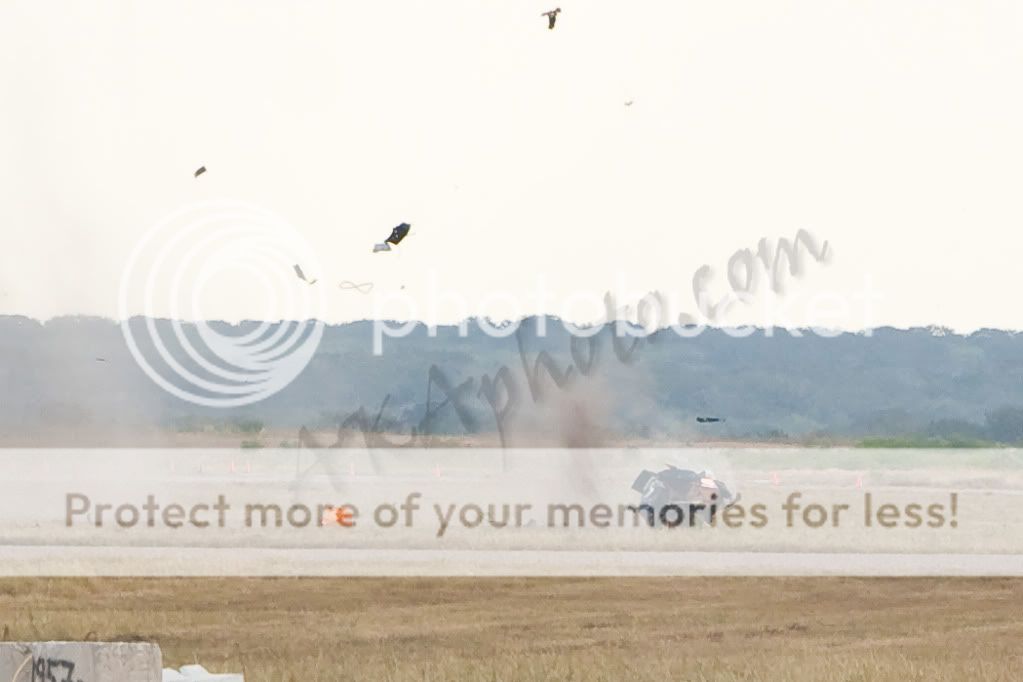

Major crash at the Texas Mile
Mullet
Oct 21, 2008
2,468
from another forum.
The guy who got this photo has it on video.
Mullet
Oct 21, 2008
2,468
also, Richard the driver was strongly advised to go to the hospital overnight for observation. He went.

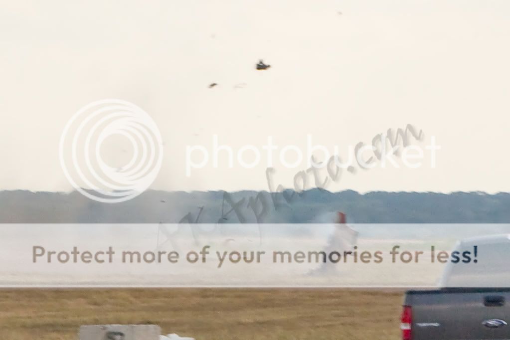

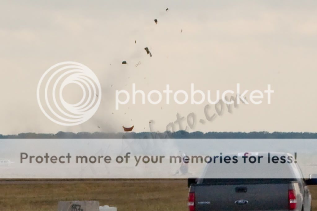

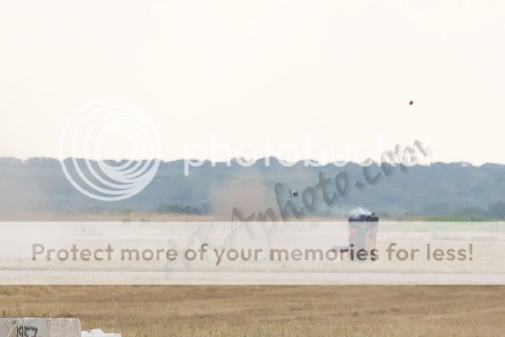

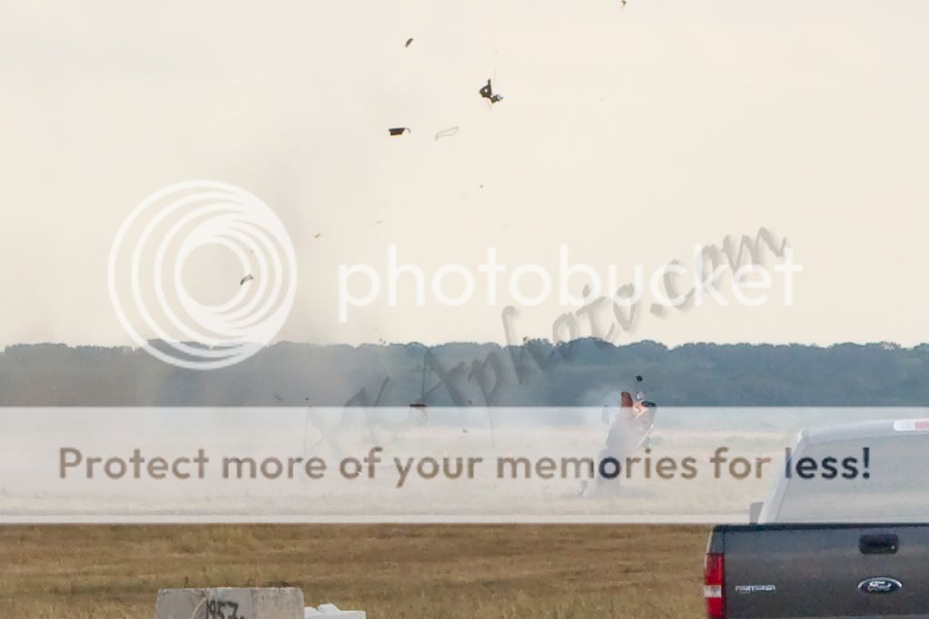

Outkastscc
Oct 17, 2007
137

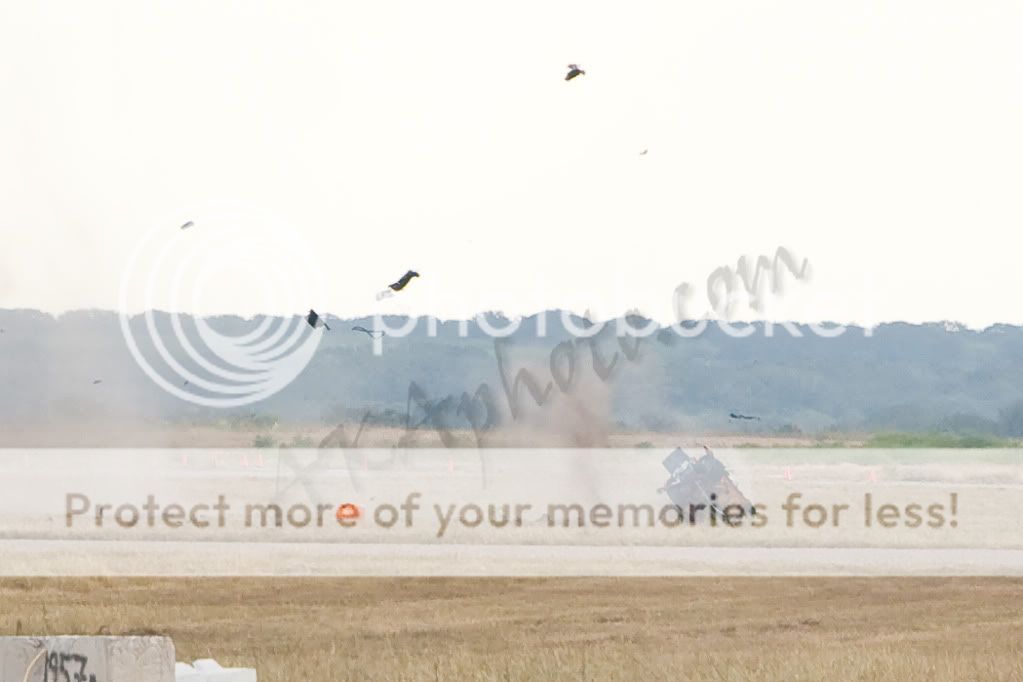

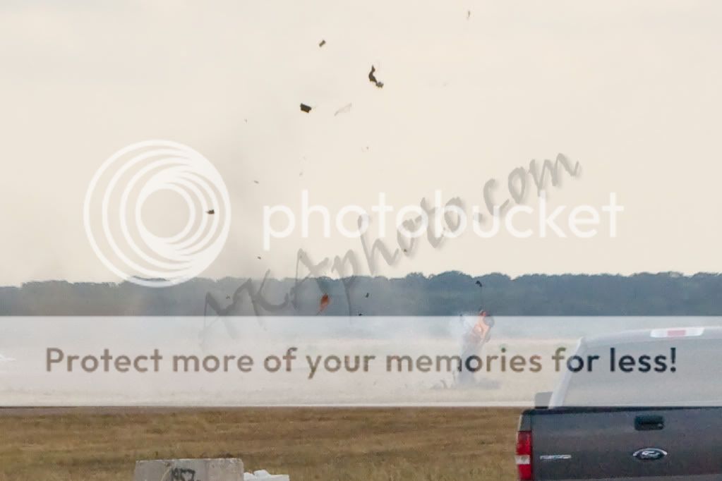

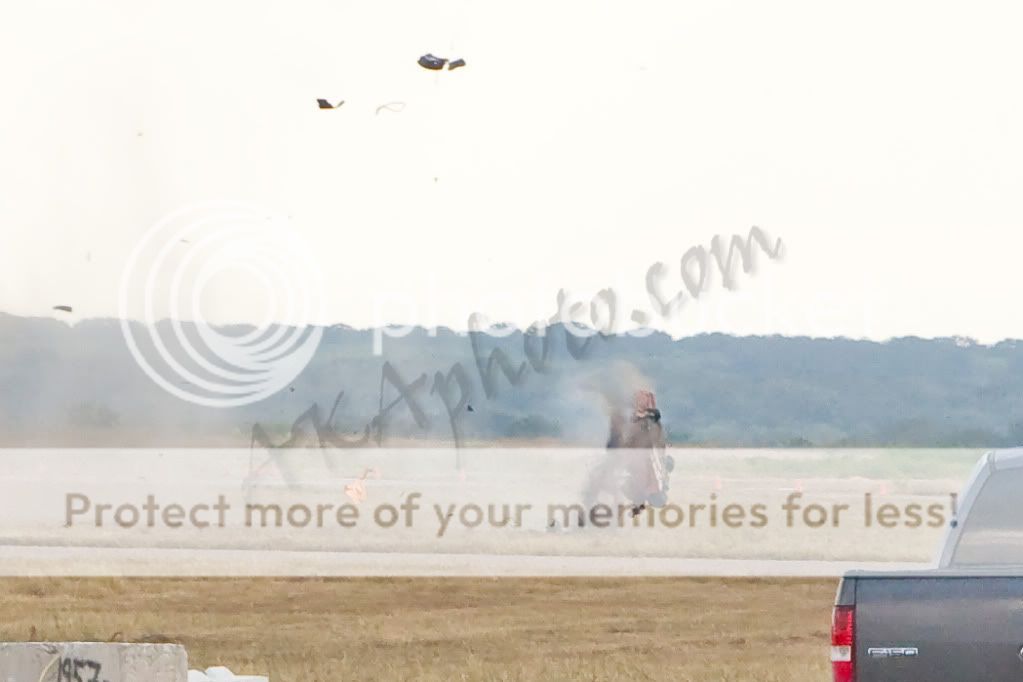

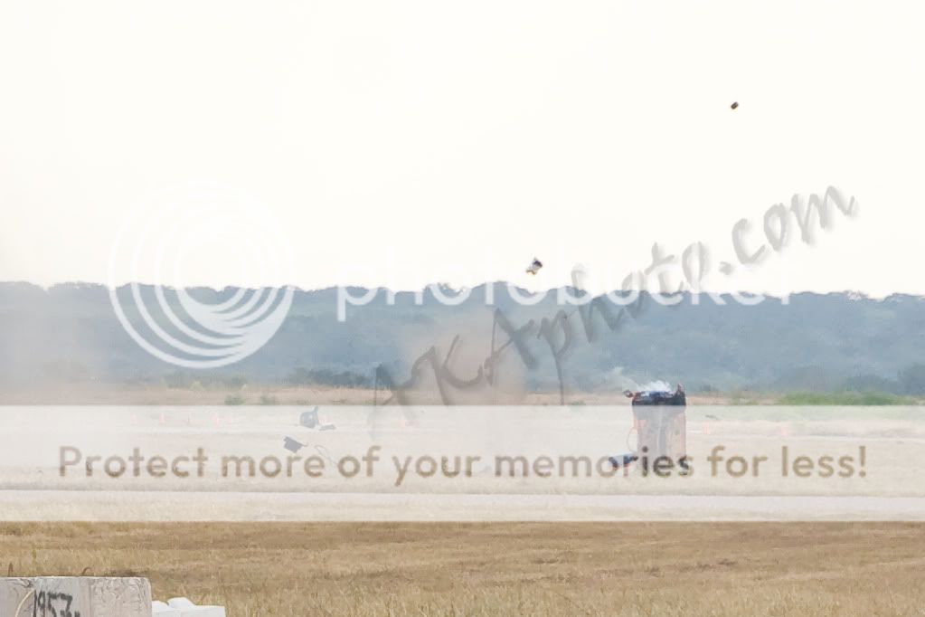

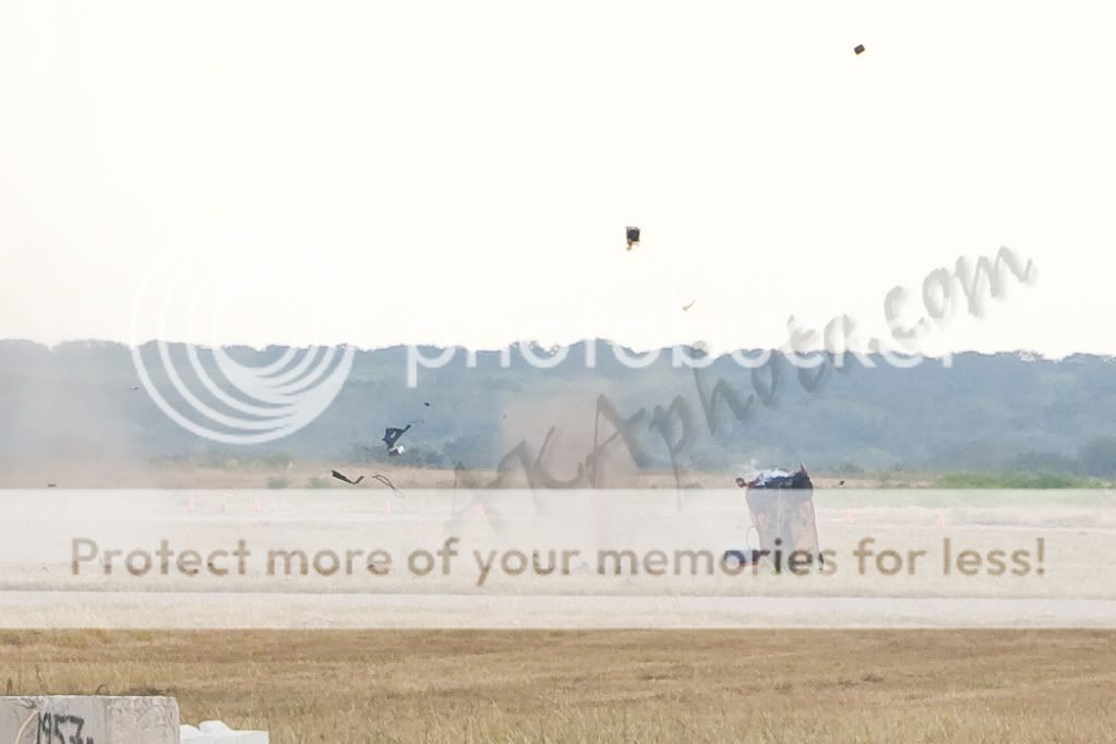

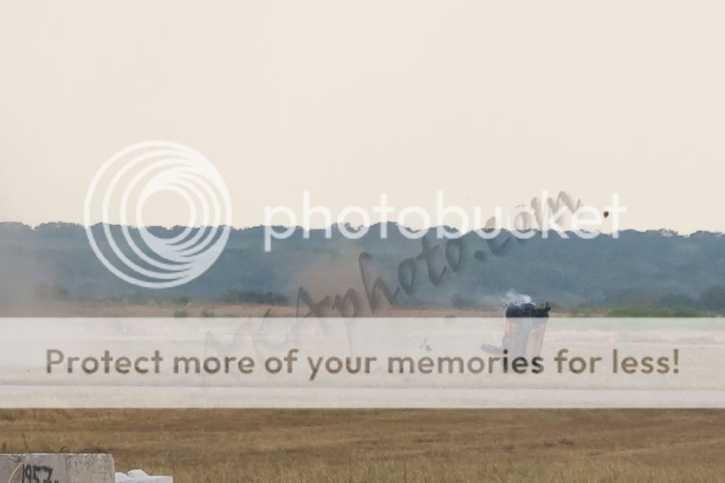

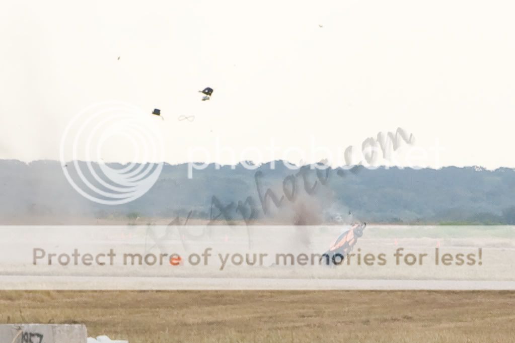

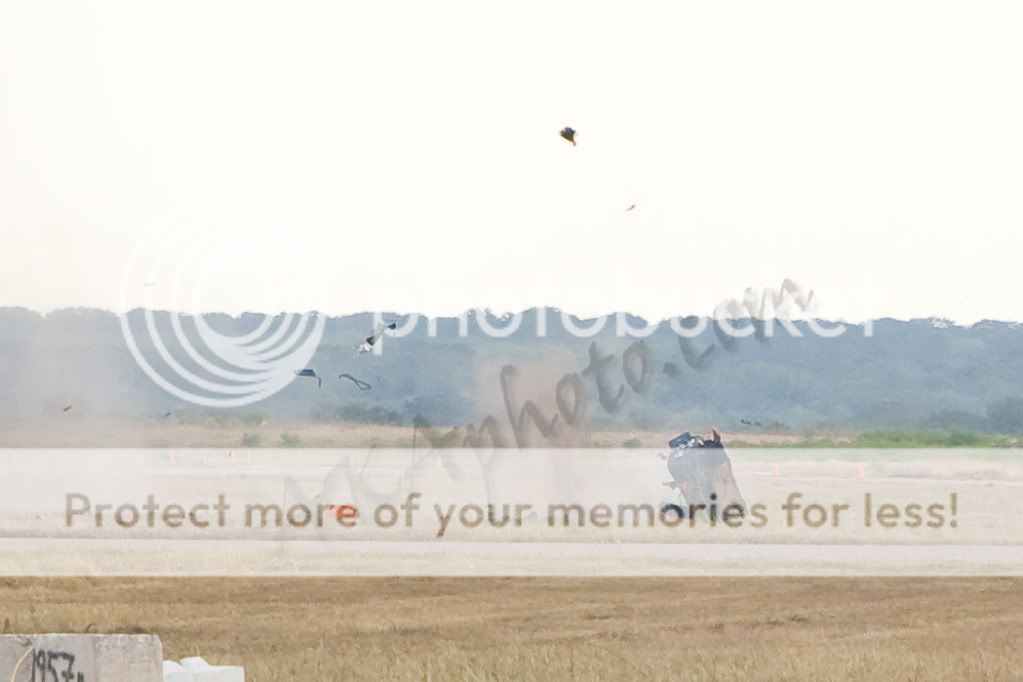

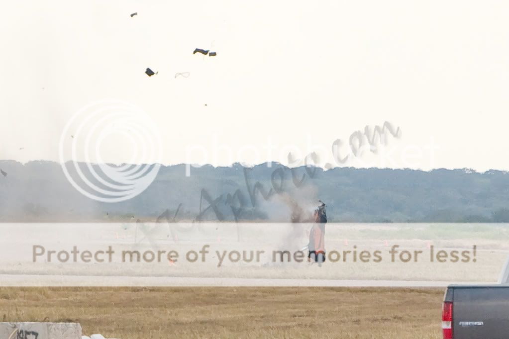

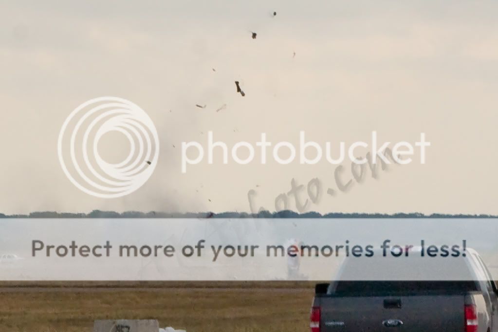

That pic Mullet posted was taken by my buddy from our pits.
Here are the rest.

any way to put those together in a moving .gif?

Hate to see and hear of something like this but great pics. If you don't mind my asking what type of camera/lens was used and how close was your pit spot to the accident?
It is amazing that driver walked away. His first call after family should have been to whomever installed the cage on that car. He owes them big thanks.....and a few drinks.

I'm thinking that's the last run anyone is gonna make in that Gallardo. Damn I'm glad he wasn't hurt bad, from those pics I would have guessed different.
5,783
No I think this was his first or second run Chip.
Yeah, I'm pretty sure you're right. It was his second run where this happened. Mullet told him that he was a tad off line and that cost him some speed. His next run was a lot cleaner.

Judges score 10 10 10 10 10 10 and a 9.9 from the Russian judge that said the second cartwheel was a little sloppy.
Knowing the driver walked away is amazing. I heard he made them stop for the time slip when he was heading back to the pits and he wanted to go right back out in another car.:eek Fortunately his pit crew must have talked some sense into him and he went to the hospital for observation. I bet he was sore the next day.
Go to the top of the page, put your arrow at the bottom of the scroll bar, (just above the bottom arrow) and press the left mouse key.... Works pretty good. You can even do it in reverse...
