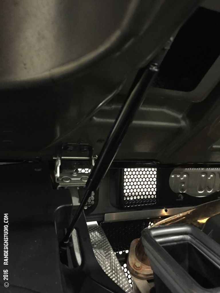

Just replaced my original clamshell lift assembly with a new set this morning, as my clamshell was not remaining open on its own.
Super easy to do. They just pop in and out of place. Used a set of locking vise grips on the old set to hold while I replaced.
The new ones work so much better than the worn out ones. I do agree that the physical dimensions of the units seem quite slim.

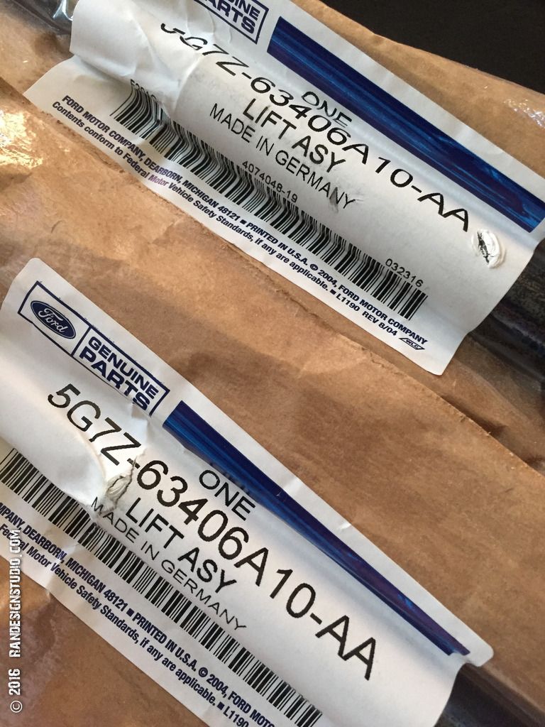

Here are pics of the part numbers.
