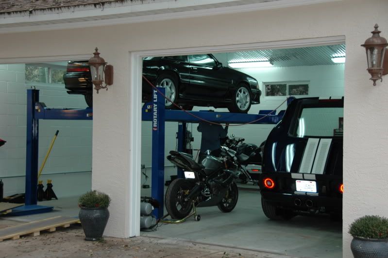

I have a DANMAR 4 post lift....
Cost delivered $1867.00
Time to construct 6-8 hours depending on your patience..
Love it!!!

3 cars in a two car garage - nice Timmy......
I going to be at 5 cars in a 3 car by the end of this year with two lifts... one holding up a 5,900# Cadillac :eek
Think I'll go Sinovac's route of a 12k lift there but matching BendPaks will look good.....
.........to Chips earlier post about maximizing the height, i had my one G door raised within 6" of the ceiling as you can see in the Pic below. Cost $750. Done with track extensions. Now the limiter is a beam at 10' 6'. Now I have to do the other door......
....and believe it or not, 3 motorcycles fit in there too.... dirtbikes and one is timmy's 50, but non-the-less, 3 :cheers
