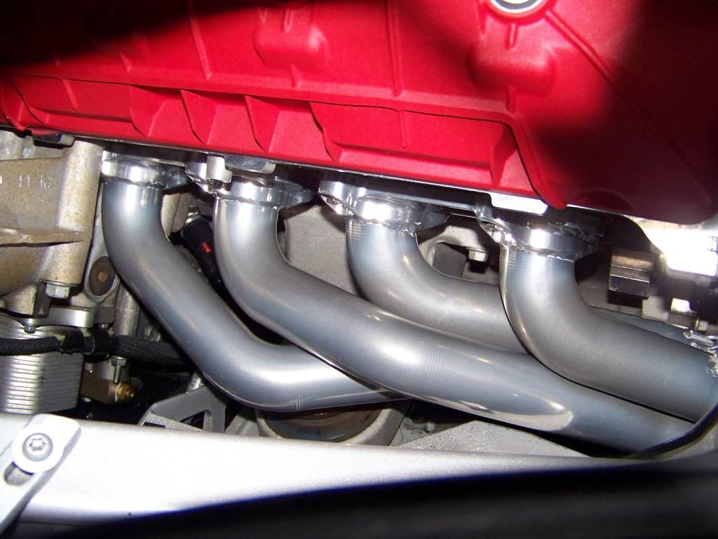

Headers are a must if you can get away with them in your state. Not only do they look great in the engine compartment, but they sound awesome. Easy to install on the GT too. Get them Jet Hot coated.
I've been told they aren't worth much power unless you're over 650whp? Also does the heat deteriorate other things in the engine bay?
I've got an air back squeak that is driving me crazy, is there a trusted source to fix this stuff in DFW? When you apply pressure to the air bag cover it goes away.
5,862
With a pulley/tune you are about there with the RWHP. The headers will allow you to make similar power with less boost, which is a good thing. You'd be removing the cats, so less heat in the engine compartment. The ceramic coating helps a bunch with heat too.
Heat shielding on the starter solenoid and clutch line takes care of heat issues.

Congrats on a great color choice! I checked out your car last winter in Southlake. Clean. I did the Borla headers and had them coated matte black by Jet-Hot. They look great and I've had no issues. They are paired with the Ford racing Borla exhaust. A bit tame at idle and under 2k RPMs but at WOT the thing screams.

+2 or 3 on the headers.

Headers are not that effective as a power adder 10 to 15 hp max that you won't feel.. and the down side is you add a lot of heat generating surface area the engine bay, It's a lot of work for virtually not noticeable gain.. A Pulley & tune is the best bang for the buck and an x-pipe will give you the loudness you desire , save you weight and increase the air flow thru the engine bay and give you the reliability of the stock exhaust manifolds which flow very well. you'll end up with 630 to 650 hp at the wheels..

Agreed with Stormcat. I feel the headers have more adverse effects than positive ones in my opinion. And I wouldn't call them a simple install either. Just my opinion for what it's worth.
Shelby and Stormcat, are you making the distinction of headers added by themselves don't add much?
I get that, but don't most that have them use them to enhance powerboosters upstream like bigger blowers, fuel etc?
PS I don't think the engine bay heat was any worse after making the change, mostly because removing the huge muffler increased air flow substantially.
5,862
I didn't notice any increase in heat after the headers. I don't have any measurements, but it would seem the cats get hotter. Compared to other cars I've installed headers on, it was pretty easy on the GT, for me at least. Anyway, the view in the posted picture make it all worth it. The GT has the best looking engine compartment of any modern car I've seen, but the cast-iron manifolds were always a bit of a letdown for me.

Pulley and tune, Borla/FRPP long tube headers and muffler.

as for my .02 on the exhaust, if you are not going to make significant power, over 750, then I really don't think its worth the effort unless you just want the look!
as the cars are getting older moding them too much is becoming less desirable and with good reason. it all depends on what you want to do with the car if you want nice driver with good power just do a pulley tune and x pipe and you get the best of both world nice sound and a bit more power from stock. if you are looking to make way more power you pretty much have to get into some kind of exhaust and whipple and or TT .

I don't have much interest in a larger blower as of now. If I'm not happy with 650whp then it would get twins, so it seems like headers will be a waste. Thinking this as of now.
-accufab TB
-air inlet support
-X pipe
-SCT
-2.7 pulley
I'd like to think that'll be fun enough, and drivable on 21" Sport cups

Stainless works headers small custom mufflers and custom pipes bent out the back . Sounds ok at idle and cruise. At W.O.T it is a race car . I have not got pulled over yet for loud exhaust and I drive a lot. 30k on my car . I like the sound as much as the power. Seems no hotter under the shell . I do have a custom intake so the holes for the stock intake are open and the air now cools the engine bay. My borla box did sound nice but it is heavy,big and the seems are weak if you make power over 650. Come see hear and drive my car if you want and you will be hooked . Let me know .
