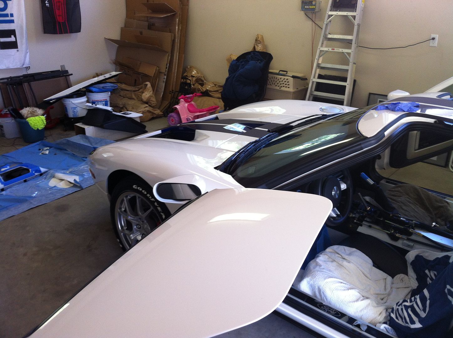

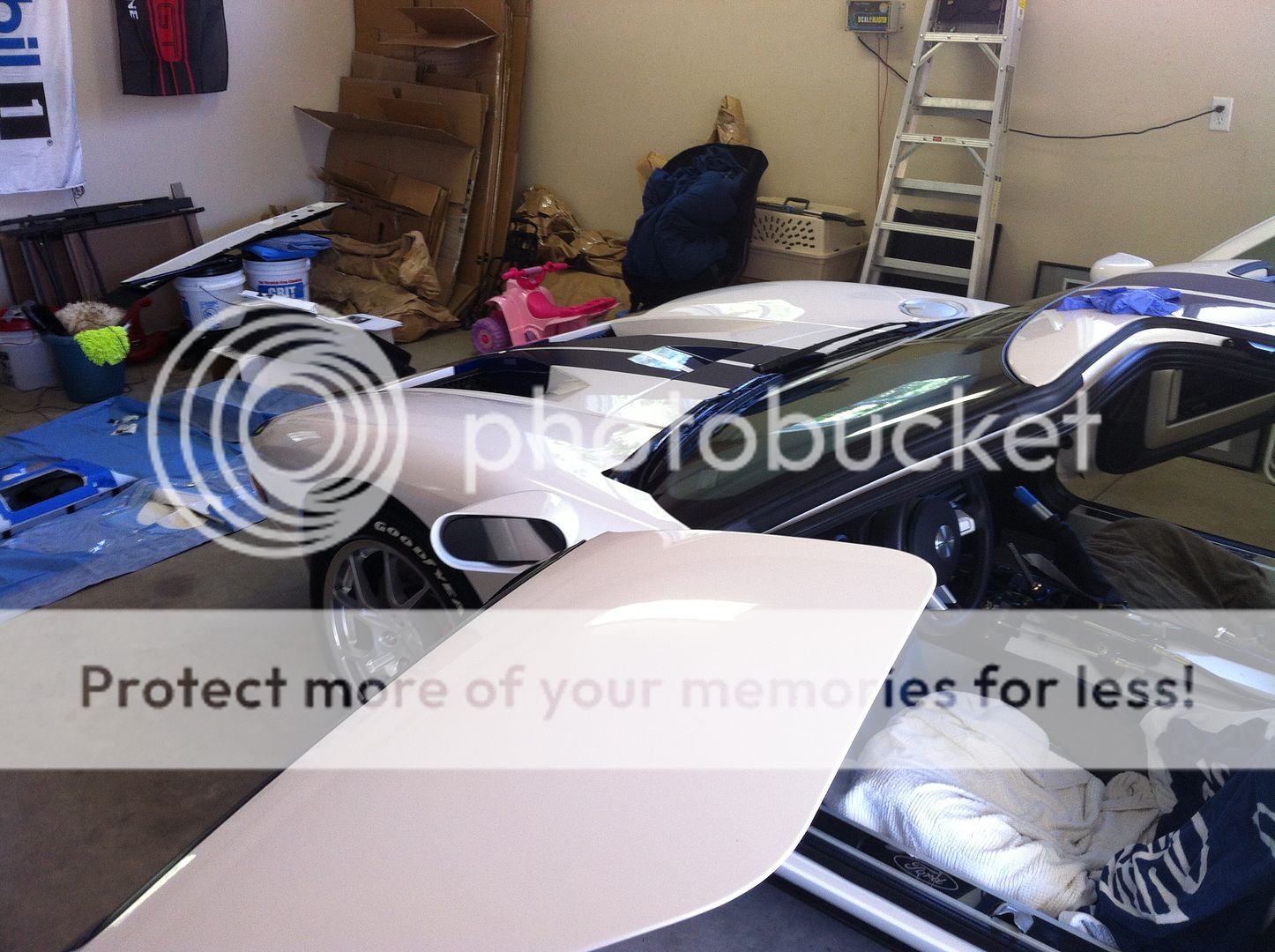

Too late Kendall:) I got home a little early today, did some stretches:), and got back at it. Decided to give Clinton's suggestion a try and opened the clamshell to look at the cables at the transaxle side. How in the world anyone can reach those without taking off the clam, removing the airbox AND the muffler is beyond me. Even then it would be a stretch. Too much important stuff in the way. Back to the cables on the gearshift side.
Fortunately (or unfortunately) the Mac cover was still off, so that's one thing I didn't have to do again!
I got the console off a bit faster today. Removed the shifter cables without taking off the bracket (not easy). The ball joints do come loose MUCH easier after they've been removed once before. Couldn't get the lock nut loose on the center cable, but fortunately, all I needed to do was adjust the driver's side one which controls the lateral travel of the shifter. Shortened it up and retightened the nut. Put it back together (with the retaining pins), and tried it all out again before I reinstalled the console. Voila! No more neutral slop. Once I was sure the shifter was the way I liked it, I replaced the console and sub. The Mac cover FINALLY went back into place after a lot of cursing. Now.....I can't get Andrew's shifter bezel to work anymore. Arrghhhhhhhhh!!!! Back at it again later tonight:( At least I got all the 'big' stuff done.

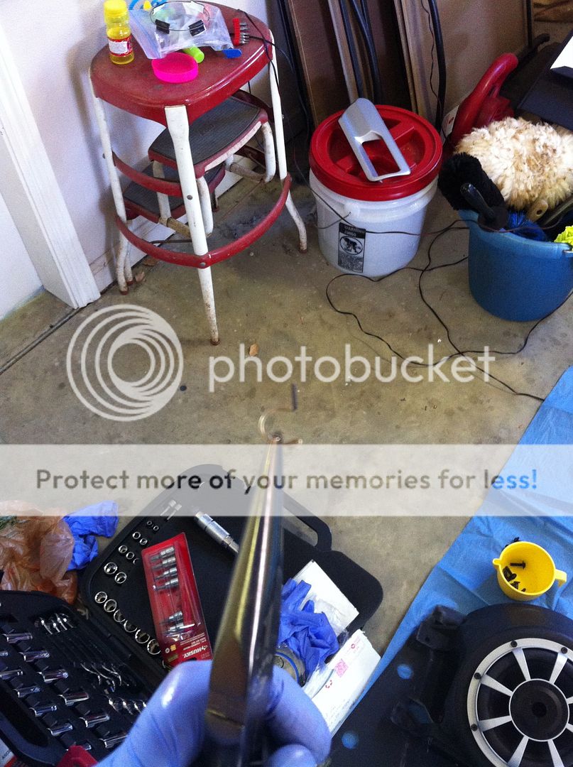

Blurry pic of the retaining pin, in case anyone was wondering what it looked like out of the ball joint

...Blurry pic of the retaining pin, in case anyone was wondering what it looked like out of the ball joint....
Looks like a standard e-clip....
bonehead
Aug 18, 2012
2,827
No, but the two gold clips that hold the shifter cables down are more like e-clips. Not sure what you call this??
BTW - don't F' Up the ball joint (which is surprisingly easy to do) as they are a B!tch to source. Ask me how I know.
You can't purchase the ball joint alone as there isn't a part #. Ford wants you to purchase the entire shifter cable.
