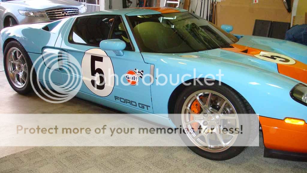

These tires fit the OEM wheels perfectly. I had the whole weekend but spent both days on the Lotus touring and autocrossing. I'm promising myself this coming weekend will be a GT weekend.

Bruce, can't wait to hear about these tires. Are you missing the screen in the right side duct?
You scared the s*@# out of me, ran down to the garage, pull the cover and checked. :lol The screen is still there. I looked at the posted picture again, and sure enough I couldn't see the screen. Maybe it becomes invisible when photographed???!!!
