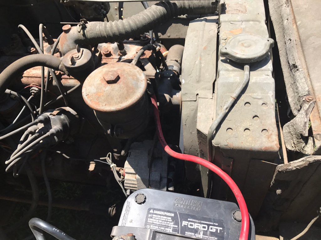

We continue to use Optima - though we fit the slightly larger yellow top YTS 4.2 - sensibly priced and well behaved if looked after.
1,781
Optima
Specifically engineered for:
Ford GT... and Willys
The only Willys M38 powered by a 12 year old Ford GT battery!

Optima
Exactly what I have planned for the old one....73 CJ-5 :biggrin
