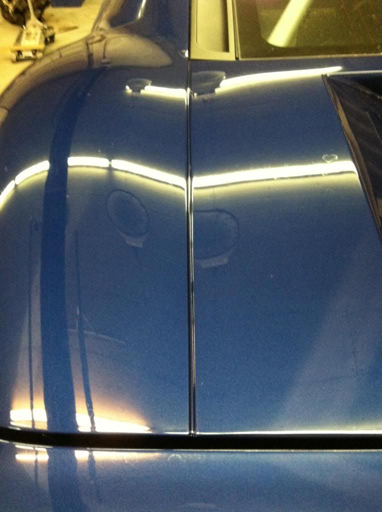

heres what the body line looks like on clamb outer where the outer half would meet the middle section on an aluminum one. The first one we made was wide and ugly and we fixed that this go around.

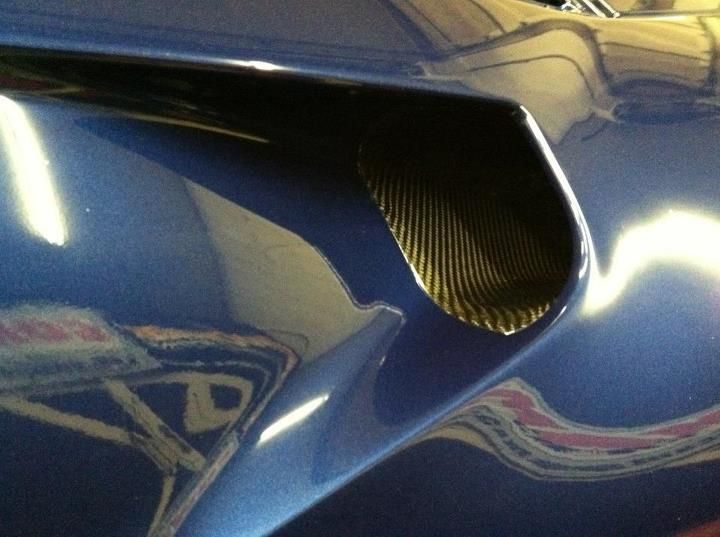

Actually they weigh real close to the same. My clamb has all the oe style hardware for all the hinges latches etc that bond inside clamb, just mine are alum not steel. My clambshell has huge carbon fiber air tubes that lead from the front openings on clamb to the air box openings and then my air box seals to the clambshell on the inside but with 3 times the opening of the factory air box hole. I just wanted as much free air to the air box as possible. It also allows for me to have a cosmetic carbon fiber bottom instead of the non pretty factory bottom. you really cant tell the clamb is a aftermarket piece from the outside as it pretty much looks 100% oe..
here is what the opening looks like on my clamb...much bigger than stock and i can also make it so it fits the stock piece in there.
