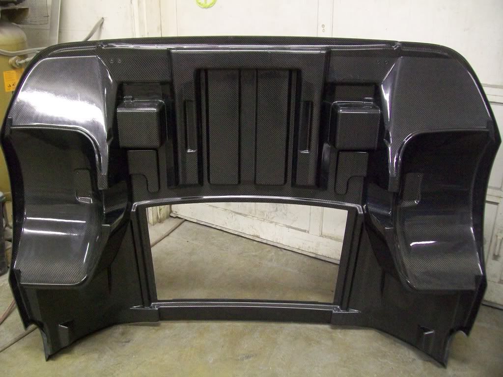

It takes me roughly 150 hours to make a clamb and get it ready for paint. There is 4 molds and a bonding fixture for it. Its a frustrating piece to make that's for sure but thanks its the coolest piece we make! I'll post a pic of the lines on the back section where the three rear pieces all come together. It looks 100x better than oe

bottom of clambshell..

Wow. That looks like a great piece. Wet or dry CF?
its resin infused.. So all the materials are layed in the mold and then the resin is sucked threw the part. Its a pretty cool process and is getting bigger and bigger amoungst the industry.
