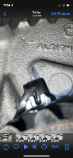

The most important part in all of this was in making sure the oil pump belt tension got set correctly. Not that easy/straightforward the first time you do it. Got all of that right?
HOOKED ON GT
Oct 26, 2006
468
Orlando & Australia
No squeal....
I followed the manual on the oil pump belt loosening and removal.
Was tricky to get the belt off over the tensioner and back on.
I took a pic of the position pre removal of the tensioner and basically copied that on the return.
As it acts like a cam moving in/out to loosen/tighten and probably could go slightly tighter? but its tight now.
I watched its travel path and tracks perfect around main wheels (very slight wobble over tensioner)
Any thoughts/advice id take.
SA
4,281
Yeah... inconvenient but not so bad if you should happen to lose any other belt... but you don't want to lose the oil pump belt! Proper tensioning is important and is somewhat a PITA the first time. We always use a mirror in order to be able to see the alignment marks. See the image below. You need to use a hex key to rotate the cam and align the "gunsight". If you didn't do this, you may want to consider to take that $%^& cover back off and have another look just to make sure.
Regarding install/removal of the belt, it is always easier to remove that tensioner pulley completely - which then allows you to get the belt on and off without fear of damaging one of the ribs.
GT@50
Dec 14, 2019
941
Issaquah
IIRC
If you rotate CW, the tang with the red scribe doesn't land on a machined boss on chain cover(I think it's the chain cover). If you rotate CCW like the stamped arrow denotes, the tang WILL rest on the machined boss. I think the manual states CCW but I don't have it in front of me. I wouldn't shy from nota4re though.
