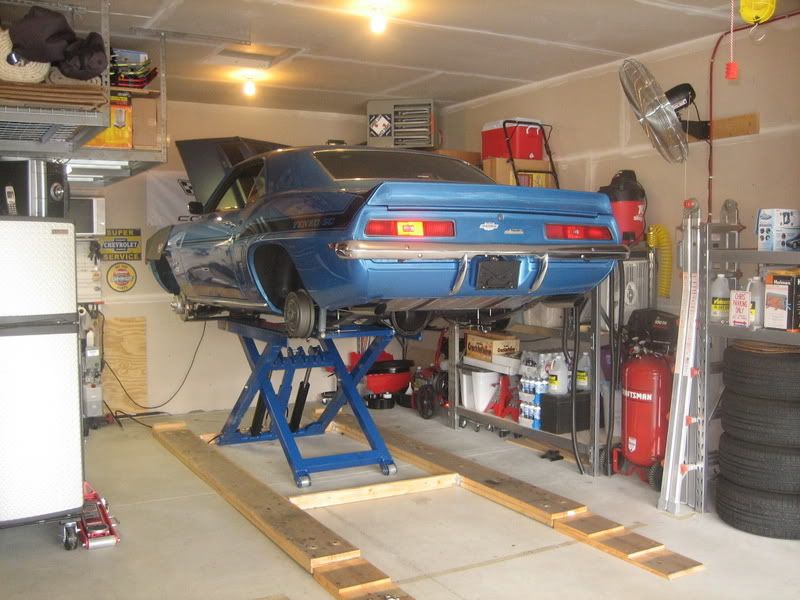

Are there any medium rise service lifts worth looking at for a GT or am I destined to continue with jacks and stands as I have for 30 yrs?
If you're after a lift for 'service', aka detailing, wheels off, etc., you might want take a look at a scissor. It does not have the 'full open' bottom like a 4 post or 2 post, but it's a lot better than jack stands. Once you detail with this, you won't ever want to lie on your side doing rockers again.
Lifts to 48" or so (pad height), portable (you can wheel it around. you cannot lift it up on its side).
I've had mine for 5 or 6 years. I also have four posts, but the scissor fills a certain need. It's lifted every car I've owned, including my X5's for wheels off service. Lately it's been doing it's jackstand impression under my Factory Five project.
Caveat: you will need some type of 'ramps' to clear this lift with a GT. 'Normal' cars will go over it just fine.
