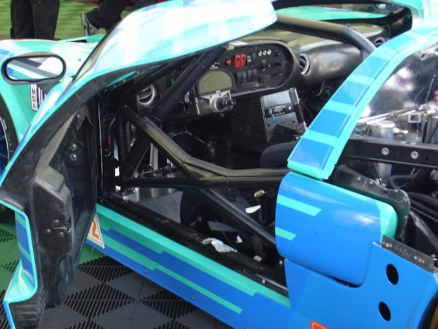

MoTec makes a nice piece to go in there Chip. The new dash with GPS mapping on the race track, it tells you right where the apex is, it's very pimp. I think they're about $8k, but you would probably want the new MoTec ECU to run it... boost by gear, launch control, stability control, meth option, espresso maker, nitrous option. When is christmas again?
Let me know how it turns out.
