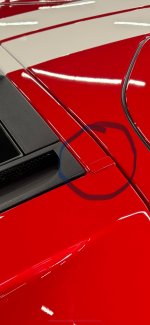

What is this
Twturbo
Sep 28, 2022
113
Upland SoCal
I saw this red car today at a cars & coffee ,low miles 2400 & noticed this bracket on both sides by the rear window ,I had to double check my car but yea I don't have them ,both cars are "05"IMG_4253.jpegIMG_4254.jpeg
drilling
Sep 13, 2018
372
So called band aid. Only on early cars with clam shell integrity issue. Correct me if i am wrong.
Reactions: Tomcat and Twturbo
KennethClay
Oct 15, 2012
877
New York
Wasn’t an integrity issue, but rather a panel fit issue. Solution? Cover up the panel gap with a bandaid clip! Both of my 2005 FGTs were early cars and had them. The later cars did not.
Reactions: Tomcat and drilling
4,256
Neither an integrity or a panel fit issue but rather a "rule" inside Ford at the time that any visible body seam had to be covered. I think the first 500 or so 2005's had these before common sense said that the band-aid looked worse than the exposed seam.
Twturbo
Sep 28, 2022
113
Upland SoCal
Ok cool thanks for the info, so also a good indicator that it's likely to have the Billit A arms then ? i'll have to check my buddies car for them.
4,256
Yes, positively, any car with the clips will have the billet a-arms.
GTinTN
Jan 17, 2019
223
Brentwood, TN
Mine had it too. Read somewhere that the first 500 or so cars built in 2004 but titled 2005 had this.
2,394
Data point: My 2005, with a May build date, #1677, has billet arms. Apparently, there were some later 2005 cars with them too.
2,769
# 1725 with 8/11/25 build date has billet arms
Mark McGowan
Ford GT Team Alumni
Jul 31, 2006
134
Very early 2005 cars the sealant would crack, this was the short term fix till a different sealant was found that did not crack.
extrap
Jul 16, 2020
1,869
Gainesville FL
My '05 red 400442 built 12/6/04 had the bandaids, whereas my '05 silver 401459 built 9/22/05 doesn't. Both have the billet control arms.
