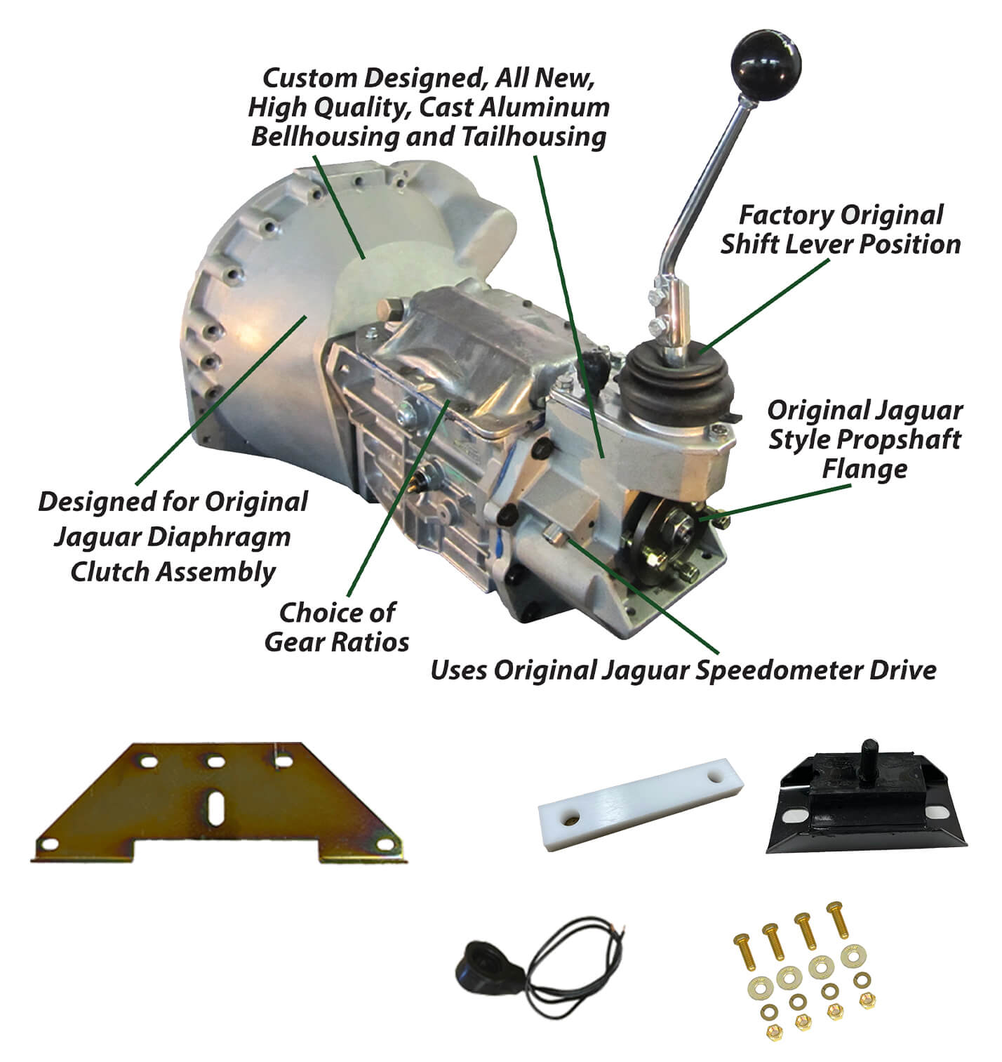

Pete what’s your thoughts on putting in 5 speed ?
There are kits to do it.

By all means do so if you’re not a stickler for originality.
Advantages: you can use a much stronger unit than OE, you can get overdrive ratios, whereas the OE 4th was direct 1:1, which revs pretty high at highway speed. I don’t think overdrive units were available in Jags, although they were available options on other British cars. So a 5-speed makes a lot of sense. I took a quick look around the internet and it appears that several vendors offer bolt-on kit conversions using Tremec T-5 trannies and others. The shifter even ends up in the OE location. You’ll never wear out or break a Tremec with the Jag 3.8 engine. Others I know with E-types have said it’s a pretty popular upgrade.
Join the jag club and look at their info about the conversions.

Cool thanks! I’m gonna drive and see how it is before I make a decision. It actually has a 4.2 L motor in it.

I took your advice and joined the Jag club. I’m gonna look around for that five speed transmission. But I’m curious,in today’s world. Is it safe to call a transmission a tranny?

I planned on putting in a five-speed when I bought mine, but they don’t need it; four speeds are enough. The only question is what gearbox is in it now? It’s an early car so you should have the terrible Moss gearbox with no synchro on first but.....you say it’s got a 4.2 motor, so maybe they put in the matching all-synchro box with it? If it’s still the Moss then I’d say change it out - originality doesn’t matter because of all the other modifications on the car. If it’s the later box, drive it for a bit and you’ll probably find (like I did) that the four speed is just fine.

The xkes really need five speeds or overdrive here in the states, as they changed the rear end ratio to give it more off the line (the later year dual stromberg carbs and reduced compression had to be compensated for. So although the later cars are really great off the line (of course no where near our Fords!!!! LOL) they have no top end without the rpms screaming.

I did a couple diffs and a tranny for a guy, 64 and 67 XKEs. He did a Tremec in one too. He brought in pics of one that's completed, purdy!!

Better than “trans” I suppose. 🤔
Try these links:

It a series 1 with a 4.2 with the Synchro gearbox. I’m going to take your advice and try it obviously with the four-speed.

Pete
Any idea which is best?
