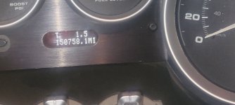

Interesting. So if we pull the sending unit no additional milage is added to our cars odometer and I am still able to drive?

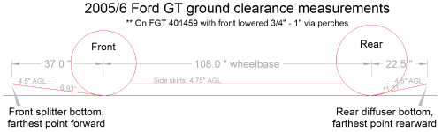

Had a question about how the GT handles speed bumps and driveways with a modest slope. Do they bottom out. Do they have some kind of lift system? Anyone experiencing a problem with that or if you can provide some insight? Thanks

You'll have to try it out but the front splitter often scrapes. I had to approach my driveway at an angle to get the left front over the "california curb" and then rest would clear OK.
There are a couple of places that make curb steps that soften the approach. They are formed but "hollow" so water flows through them so as to not create too much of a dam.

Congrats!! 🍻 But no, unfortunately there's no factory lift system. I haven't made contact on a speed bump so far, but I go reeeally slow, creeeeping up and over and even down the backside. And my driveway has a single transition that sure feels like the car should hit but it never has yet. Also, note to keep in mind, my front has been lowered 3/4" - 1" via the perches method. In case you wanna try to measure your driveway, here are the relevant measurements I made of my '05 when setting up my trailer and ramps ... and as you can see if you can creep over speed bumps, you'll prob clear all but something higher than ~4.5".

It will only scrape on the bottom. You need never even see it. Scrapes happen, don’t worry about it (from a well scraped bottom!). The worst that would probably occur is you would need to straighten the aluminum rods that hold it in form to remove the “smile” when it bends the rods.
That's definitely the more fun approach ... shit happens, occasionally you're gonna scrape, nothing tragic, don't worry, be happy (y) 🍻
6,182
And resistance is futile. Many times here I've seen people buy a new splitter because theirs is scraped only to get it scraped again.

Watch for the risers at gas stations.
