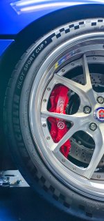

For those that actually drive their cars, just upgrade the wheels.
2,449
How long do those PS Cup2's last? In what kind of driving?
I just can’t get over the short sidewall in those.
Not too aggressive and but not babied in any way. They've lasted but would like to try the PSS5 next time. Cups really fling the stones. Both far superior to the Goodyears.
