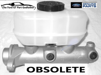

I believe the 2004 F-150 is a real close match. I believe it's just the location of the switch that is different.
attached is a photo. Same supplier (Tokico) and "71" on the side. I've never tried it but always thought it's worth a shot if mine goes bad.

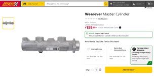

You might try AdvancedAuto for a remanufactured one. You would need the reservoir from the old one.
