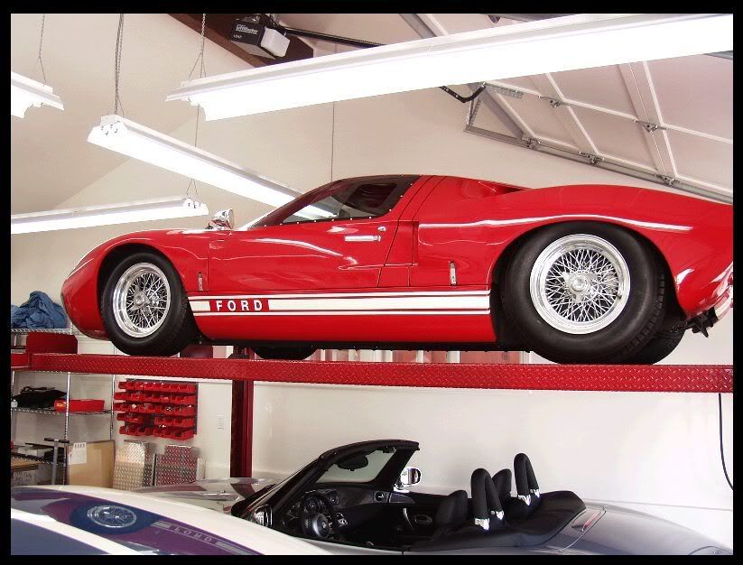

Here are a couple of pics I have
This one is the introduction of the GT40
This one below, is from my neighbor's collection in 2002. AN original 1966 GT40. Car subseqently underwent 1.5 years of restoration in Minnesota and change in color and won Pebble Beach several years ago for post war best of show.
Notice the wire wheels in both images

If you find a manufacturer of 18"/19"/20" wires in knock-off config to fit our cars, along w/hub adaptors...count me in for a set and keep the rest of us in the loop!
The reason that you don't see wires on modern cars is that they will not stand up to the torque and g loading that our cars produce. I would be very cautious about moving forward with this idea. They look good, however require regular tuning.
What Daniel said.
In fact even back in 1963-64 the had to abandon the wire rims on the Ford GT because of the torque produced.
Also it is a lot more difficult to make a 18"/19" wire wheel than a 15" one.
8,145
That red original gt40 looks BEAUTIFUL
