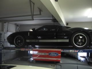

I am soon going to purchase a lift. I've read a lot about different setups guys are using on here but wondered if I could ask for specifics. What model is this and what accessories are needed to be able to get all four wheels off the ground at the same time? Sorry for the hijack.

The lift I have is the WIDE Body lift as they show a 116 3/4" version the HD-9XW. It appears to be the same as I bought and found the tape measure to verify as I write this post. I had the option to move the non ram ramp further out 4" which is perfect for the FGT. With the FGT never compromise the width of the gal... Her hips are wide and flowing!
To get the wheels off the ground they had a rolling jack of which I have an older model that fits under a lowered FGT.... The new ones don't! Check with the Shadowman as he knows what will work as he stated this problem on earlier threads.
Other info sites for a lift is Garagejournal.com which I would go to if you needed to get caught up on the latest 4 post info is my recommendation.
BTW - I have no affiliation with Bendpak but I use it daily and am still happy after 2+ years...
