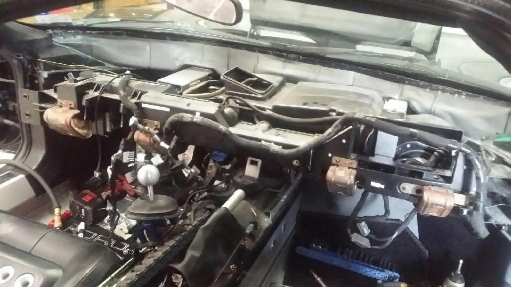

Update to MY no heat issue
Like I said in my eariler post,if would be difficult and/or expensive to fix, it is what my car would need. The blend door stuck, shop was unable to fix without doing this:

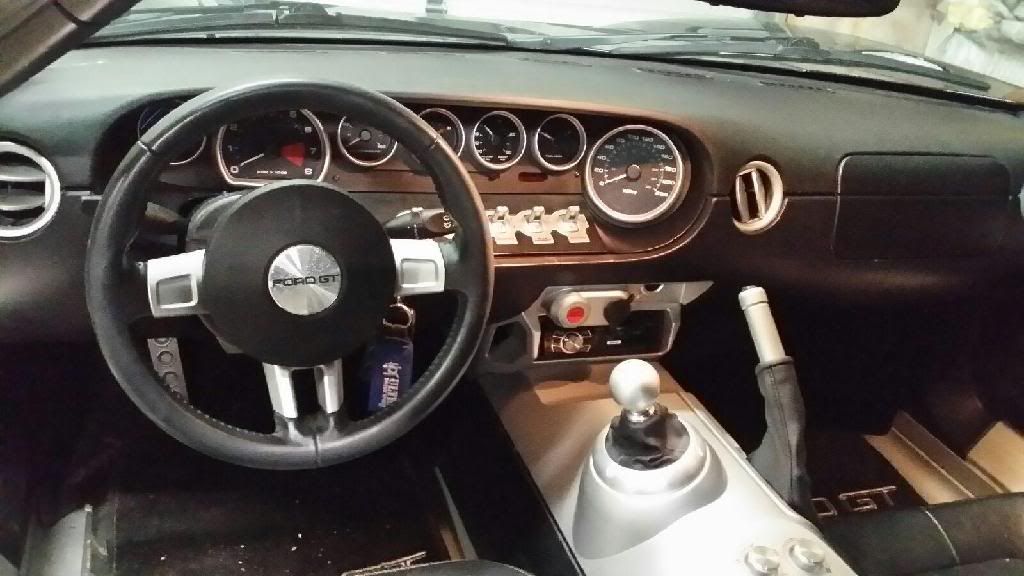

Well, 24 hours later, all back together......and the heat works :) Put in Andrews shift bezel and boot cover while it was apart.......
Thanks Andy. Nice work!
ben
Darthvader
Aug 4, 2007
287
LufkinTexas
Thanks! Completed in 16 hours!
