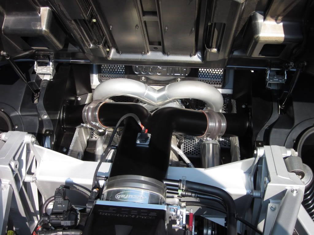

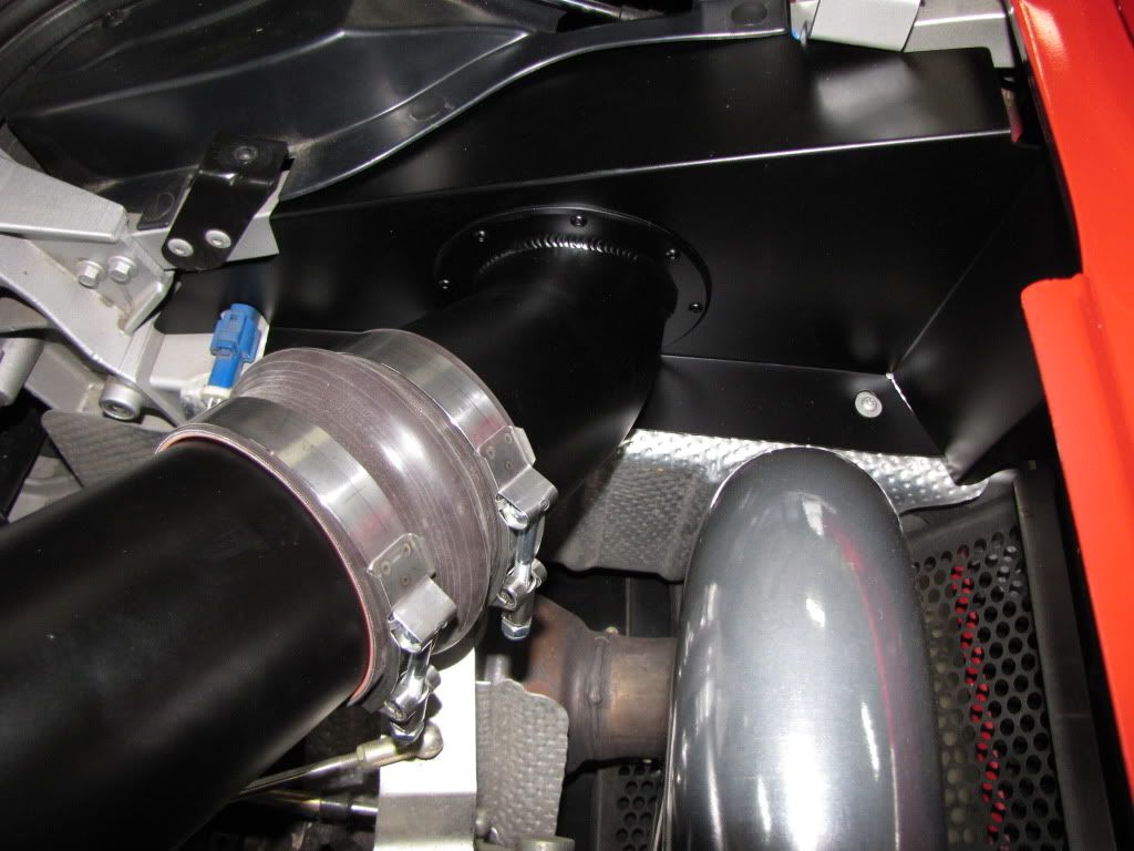

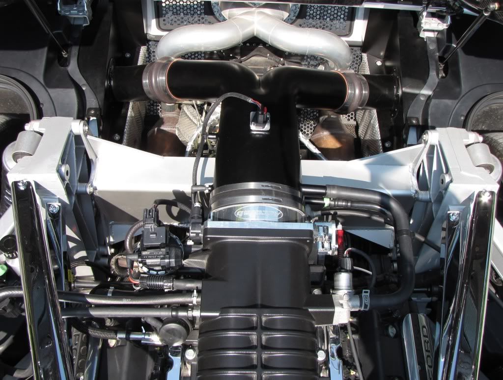

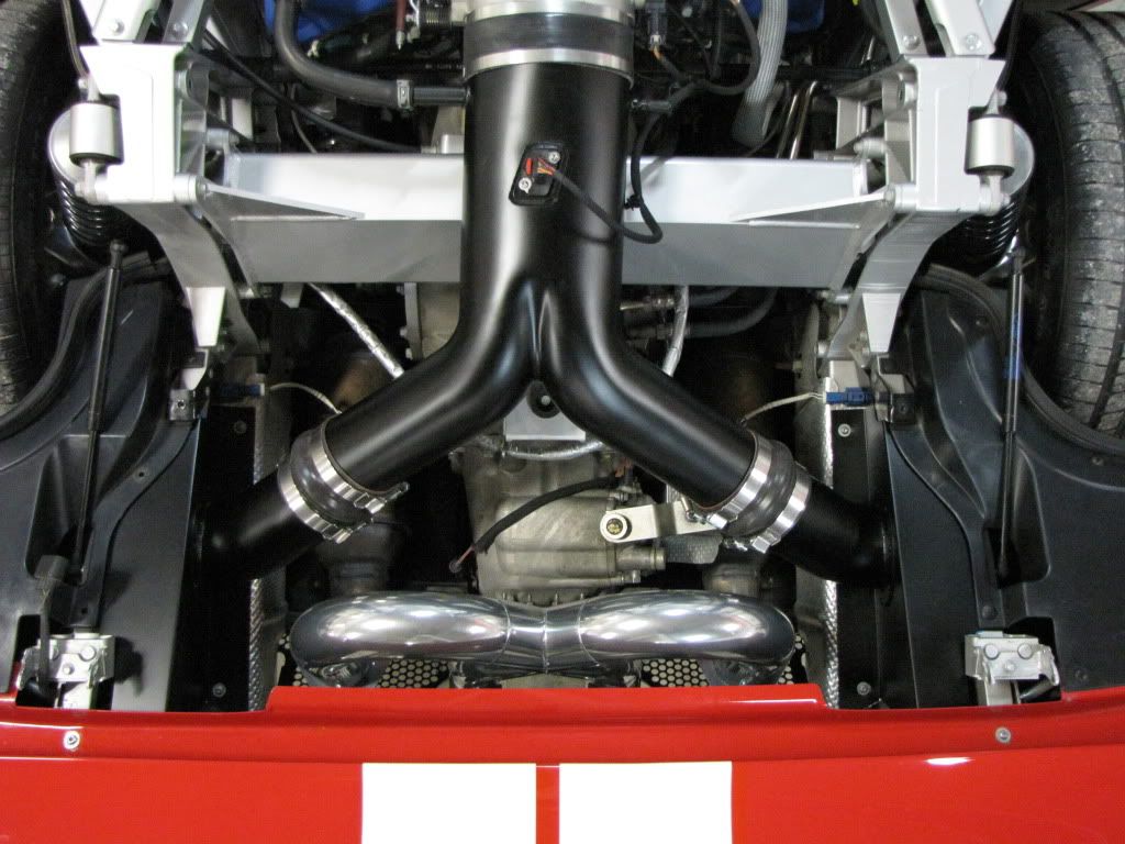

Well the time has finally come. After almost of year of development time we are ready to release our Ford GT cold air induction kit. Previous post from 427Aggie http://www.fordgtforum.com/forums/s...-up-for-a-cold-Air-Kit&highlight=cold+air+kit We are in the process of kicking off manufacturing and looking to see how many are interested in our kit. This kit pictured is the last prototype before the production run begins. We will be manufacturing them in black polyester as to give it the OE look or it can be painted body or custom color. The assembly is set this up to be a completely bolt on and reversible. All of the mounting points are from existing rivnuts or holes in the chassis and can be installed by anyone. Seeing how this allows more air into the engine it will require a custom tune that will need to be purchased or acquired separately. From the testing we have done on a stock supercharger, 2.7" pulley, Accufab monoblade car this kit picked up 35rwhp and on a 3.4L Whipple car it picked up 45rwhp. This is due to the kit being set up to handle up to 1000HP with the K&N air filters and the size of the tubing we chose. Now the limiting factor for additional power will be after the throttle body. We are planning on offering the kit ready to bolt on for $3995 with a possible upgrade to carbon fiber for an additional $600. Please email me if you would like to be put on our list richbrooks@thegtguy.com

GTG Cold Air Kit
Close Out Panel
Filter

Does that include the monoblade, or will stock throttlebody work as well? Who's got the tune? Are the filters protected from water (i.e. rain or washing) from below and behind? thanks Frank

We didn't include the Tbody as so many guys have various Tbodies already. We have tunes for some of the setups and are working on the rest. We feel the filters are protected from the elements as I have been stuck in a rain storm on one of my personal trips and I checked the area where there filters were and it was still dry. As far as washing just don't spray the filters directly. In the stock air box if water enters the box there are a few small holes in the lowest corners of the box to allow the water to run out.

Hey Rich and Denis, I know you ask if you could use my car for the installation photo shoot and it looks great especially on a RED car. Does this mean it will be on my car when I pick it up Saturday? HAHA. Not fair to show me what it looks like and then not leave it on. It is a high quality installation/fabrication and true performance upgrade as the DYNO shows. P.S. did you clean the inside of the fenders before you put the old air box back in?
