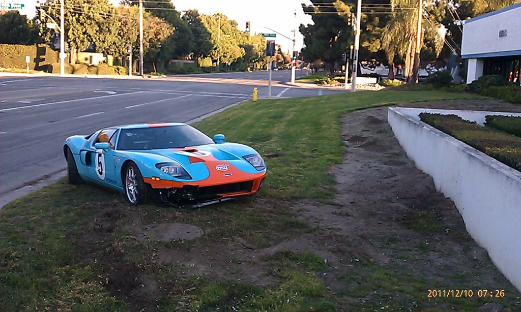

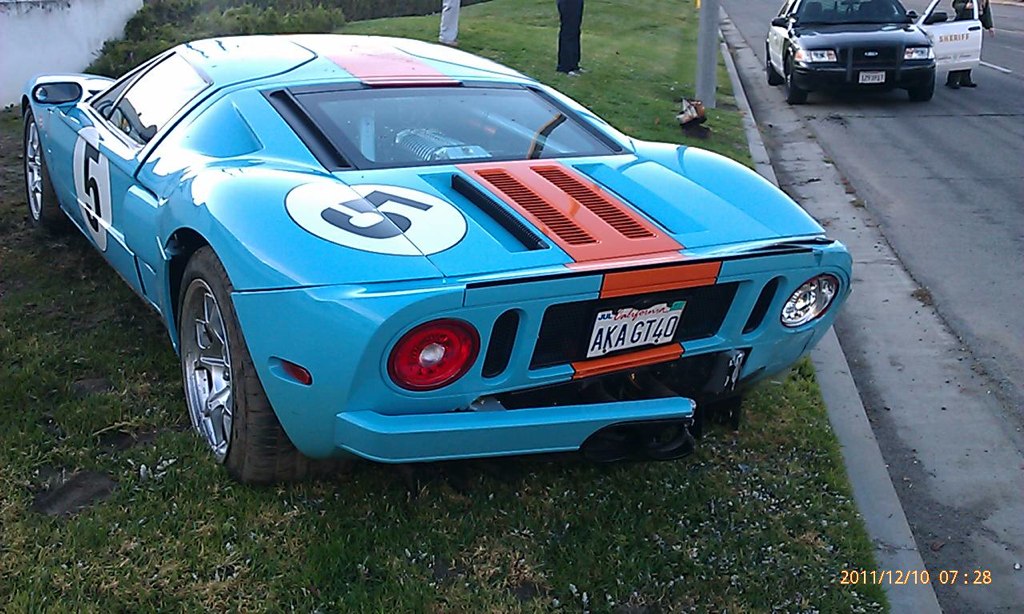

It pains me to report that I managed to lose control of the car last week, all while going straight with the tires fully warmed up and on fairly fresh Bridgestones. It all happened while I shifted in second gear and the tail started to come around and before I knew it, the right rear wheel hit the curb and hopped onto the side median and started skidding on wet grass, it then did a 180 after the rear brushed against a small tree and tore half of the bumper off.:frown So I'd like to caution my GT brothers & sisters to be really careful out there as winter is upon us and cold temps in the morning and flooring the gas pedal don't mix, even if you are going straight, even if you have driven the car on the freeway for 20 minutes!!! All it take is a blink of an eye and it is all over...

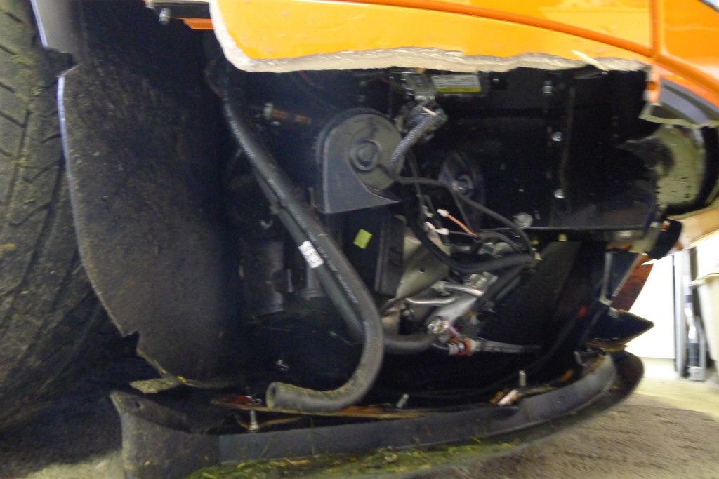

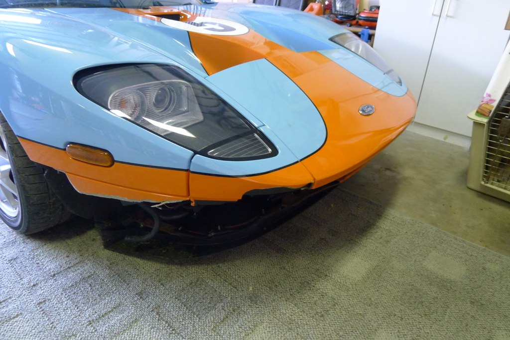

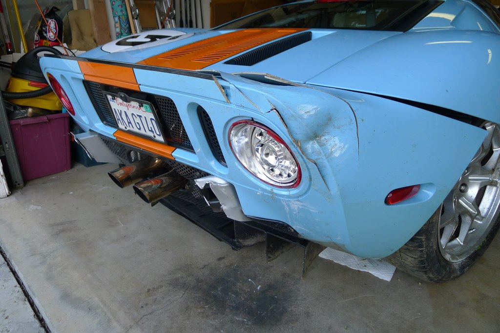

Now onto the damage and that where I need advise... So I thought the damage was bad but shouldn't be over $20K to $30K worth of repairs, but guess what? The place that I took the car to told my insurance company that the car is a total lost. How could this be? No matter how I look at the car, the damage can't be that bad. The doors open fine, air bags didn't deploy, not even the front hood is buckled, rear hatch is pinched a little as the rear section got pushed up a little. That's about it. Problem is my insurance doesn't cover the full value of the car so what options do I have now?

Wrong way to do bumper delete. Don't try this at home. Luckily the car missed the light pole on one side and the wall on the other side.
No, Ford GT's don't have four wheel steering...

Bent toe link

Bruce, as we discussed last weekend when you called, the damage to the car is very minor - hardly worthwhile IMO to justify transporting the car across the Country. The expense is in the panels and painting. In particular, both rear frame horns are damaged. These can be replaced OR you can do a RBD and likely save money in the process. Same for the bumper. The car needs a new rear butt skin and tail light - neither are inexpensive. The alignment of the rear now shifted over is very easy as there is just a C-shaped, 1" square halo bar that may need to be straigtened or replaced (it is NOT structural), and then you have (3) .5" round hollow aluminum rods per side holding the rear in position. The rear wheel has a busted toe-link (what you told me) and this also needs to be ordered.
Up front, you need a new nose piece (superficial, like the rear) and a new radiator. A new AC condensor might be in the cards as well.
80-90% of the cost to get this GT on the road again is in parts and paint. Labor is a minor part of the equation. JMO.
