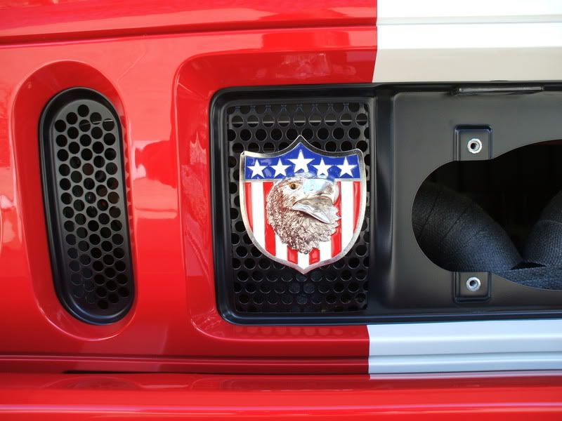

Next, I wanted an emblem on the rear of my car that had some meaning. Ever since I purchased my GT I have wanted to honor the 1967 Lemans winner since it was also red. That's also why I chose the number (1). Because the car was piloted by Dan Gurney and AJ Foyt, I have been thinking of ways to subtley honor them as well. I haven't thought of a way yet for AJ Foyt but I did think of this for Dan Gurney:
For those of you who are familiar with Dan and his company All American Racers (AAR), you will notice that this emblem is like the American shield on his logo and the Eagle symbolizes what Dan is well known for, his Eagle Racing cars!!!:thumbsup Here's a link to his website, lots of great histroical info and pics: http://i103.photobucket.com/albums/m138/jdoc7/GTonJackStands019.jpg?t=1203529008
This piece is actually a trailer hitch emblem that is suppose to cover the trailer hitch hole when not in use. I just ground down the back so it was flat, stuck some 5/16 stainless screws into the back and epoxied them in place. They ain't going anywhere. Then just a washer and nut to attach through the rear grill.
