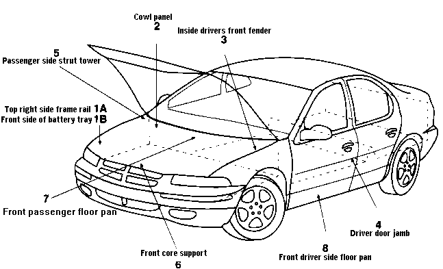

Otherwise, I will check my car tomorrow and will search for the colour identification plate (should be found at the driver door jamb 4) (taken from paintscratch.com)
"Ford owners, take note! Look for the words "Exterior Paint Colors" below. Right above it (not below!) is the color code. You would think the color code would be 54D. But the actual color code is ABOVE the words and is 19".
