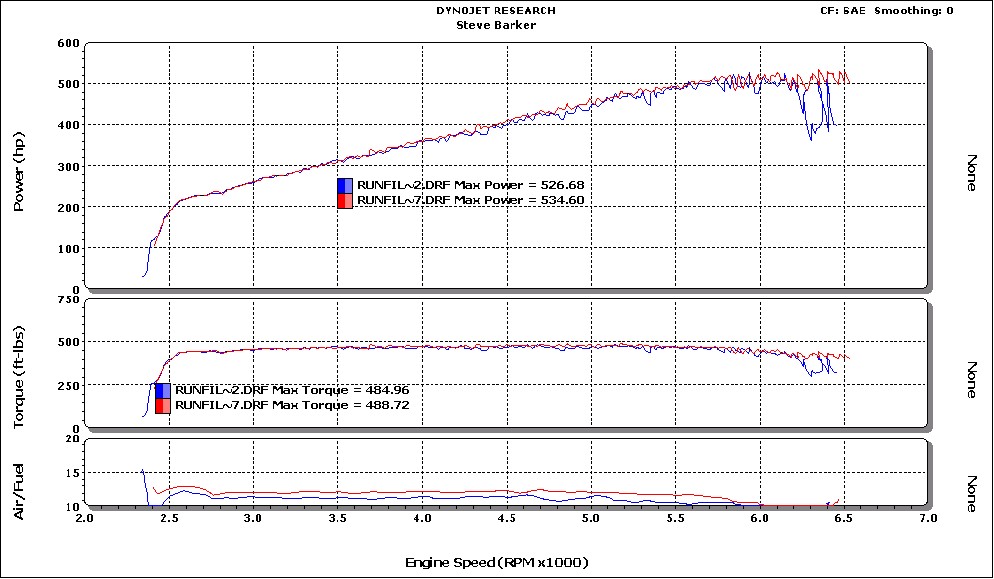

Since I have a DynoJet in my shop at home, I am able to do extensive testing without regard for time. I made a total of 16 runs this weekend with very good results. What I wanted to do was determine the power increase from the SCT Tuner with the stock exhaust, the Accufab X-Pipe with the stock tune, and the Accufab X-Pipe with the SCT/Accufab tune.
The following graphs will illustrate the results.
On this first graph, RUNFIL~2.DRF is totally stock with the stock exhaust. RUNFIL~6.DRF is with the stock exhaust and SCT/Accufab tune.
On this second graph, RUNFIL~2.DRF is totally stock with the stock exhaust. RUNFIL~7.DRF is with the Accufab X-Pipe and the stock tune.
On this third graph, RUNFIL~7.DRF is with the Accufab X-Pipe and the stock tune. RUNFIL~15.DRF is with the Accufab X-Pipe and the SCT/Accufab tune.
I make it a point to try to duplicate conditions for every run. It took me a few runs to determine what temperature this car liked to run at. It appears the best runs happen between 170* and 180*. All the runs are SAE corrected. The UNCORRECTED numbers for the best run are 563 rwhp and 529 rwtq. The STD corrected numbers for the best run are 566 rwhp and 532 rwtq.

Good info Steve, and nice segmentation on your dyno tests. In both cases your "stock" curves drop off between 6000 and 6500 rpm - and it looks like the A/F curve also dropped off (rich) because it appears to go off the plot with the y-axis scaling that is in place. Are your stock curves without the air inlet stiffener, and if so, do you attribute the A/F richening between 6000 and 6500 to the air inlet collapsing (as has often been reported)? Or, if the air inlet reinforcement was in place for the stock curves, maybe the stock tune is responsible for the A/F richening, and the dropoff of the torque/HP curves between 6000 and 6500? Thanks again for the plots.

Thanks! I put the air inlet stiffener in before running any tests. The stock tune is 100% responsible for the A/F richening above 5900 rpm. The lowest number that can be recorded is 10:1 so I really don't know just how rich it was. As far as I am concerned, even the SCT/Accufab tune is too rich above 5100 rpm and way too rich above 5600 rpm.
I don't have any experience with superchargers but I do have a fair amount of experience with turbochargers and nitrous. With the turbochargers, I am able to run between 12.25:1 and 12.75:1 safely and get real good results as compared to running under 12.0:1.

Move smoothing to 5 in Winpep and see how the graphs change

Smoothing definitely gets rid of the jaggedness on the graph. Unfortunately it just masks the issue and the issue still remains. Unless this is not an issue and all of these motors display the same tendency. Are there any more DynoJet graphs of these supercharged motors around?

And the issue your referring to is what ? My goal was not to mask anything. I cannot speak for this vehicle on this dyno. It appeared to me that he was new to using a dyno and noticed smoothing at 0. Almost everything will exhibit some sort of jaggedness without smoothing

If you remove a primary 02 sensor / replace it with a wideband and do WOT testing on the dyno it will have 0 impact. Open loop fueling does not pay attention to the 02's. Just closed loop.

The issue I am referring to is the jaggedness and what it represents. I have made over 500 runs on my DynoJet and have NEVER seen this kind of jaggedness. This includes some extremely high horsepower naturally aspirated as well as nitrous fed cars. If this is normal for these motors than so be it. I am just looking for some feedback.

I do this for a living so I know something about it as well. So your stating that you always make dyno pulls with smoothing at 0 and have had no jaggedness on your graphs until now?
