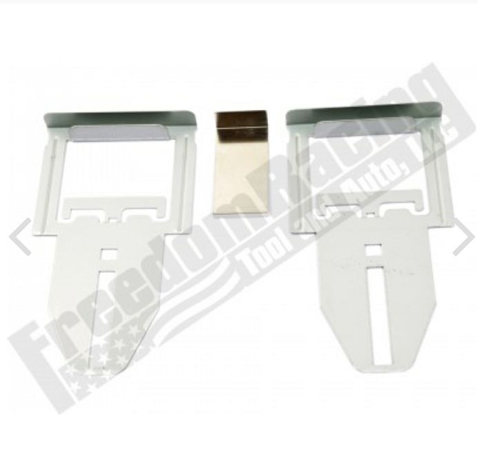

You need special tool to remove radio
1,781
Does anyone have a pic of the special tool? Is it the U shaped one or a flat key?
Here you go. PN 415-003
1,781
Here you go.
Awesome, thanks!

Blue tape around the head unit. Pry the silver trim pieces off. Slide the tools in..."handle" side out...until they lock. Pull head unit out by the tool handles.
