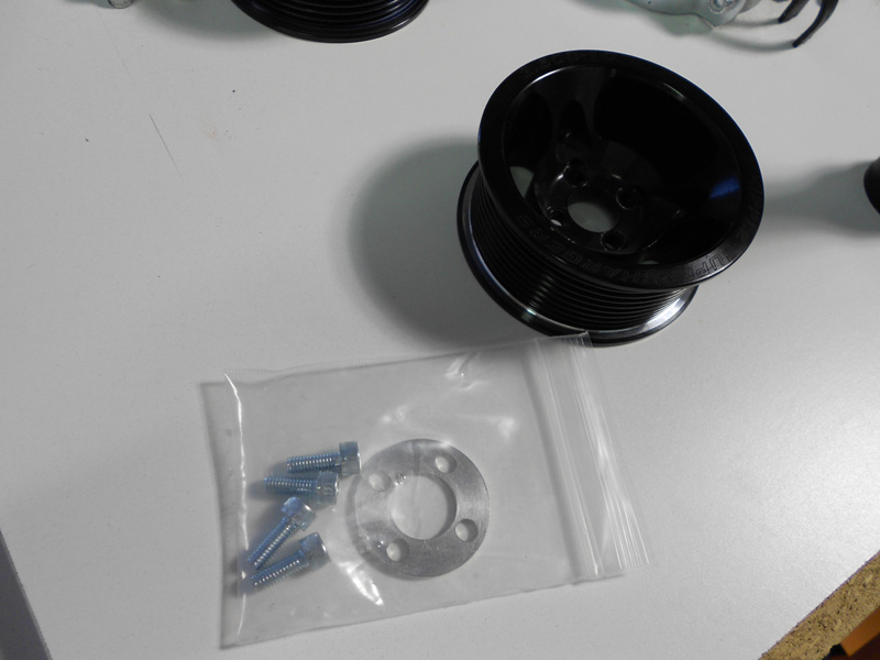

A side-by-side example showing the pulley modification.
The required parts include a .100 spacer, 4-16mm long bolts, and the specially machined pulley.
![kit.jpg](/forums/proxy.php?image=http%3A%2F%2Fguyettperformance.com%2Ffgt_belt%2Fkit.jpg&hash=5884e142e5a083ccfeb676780fc6f21d)
